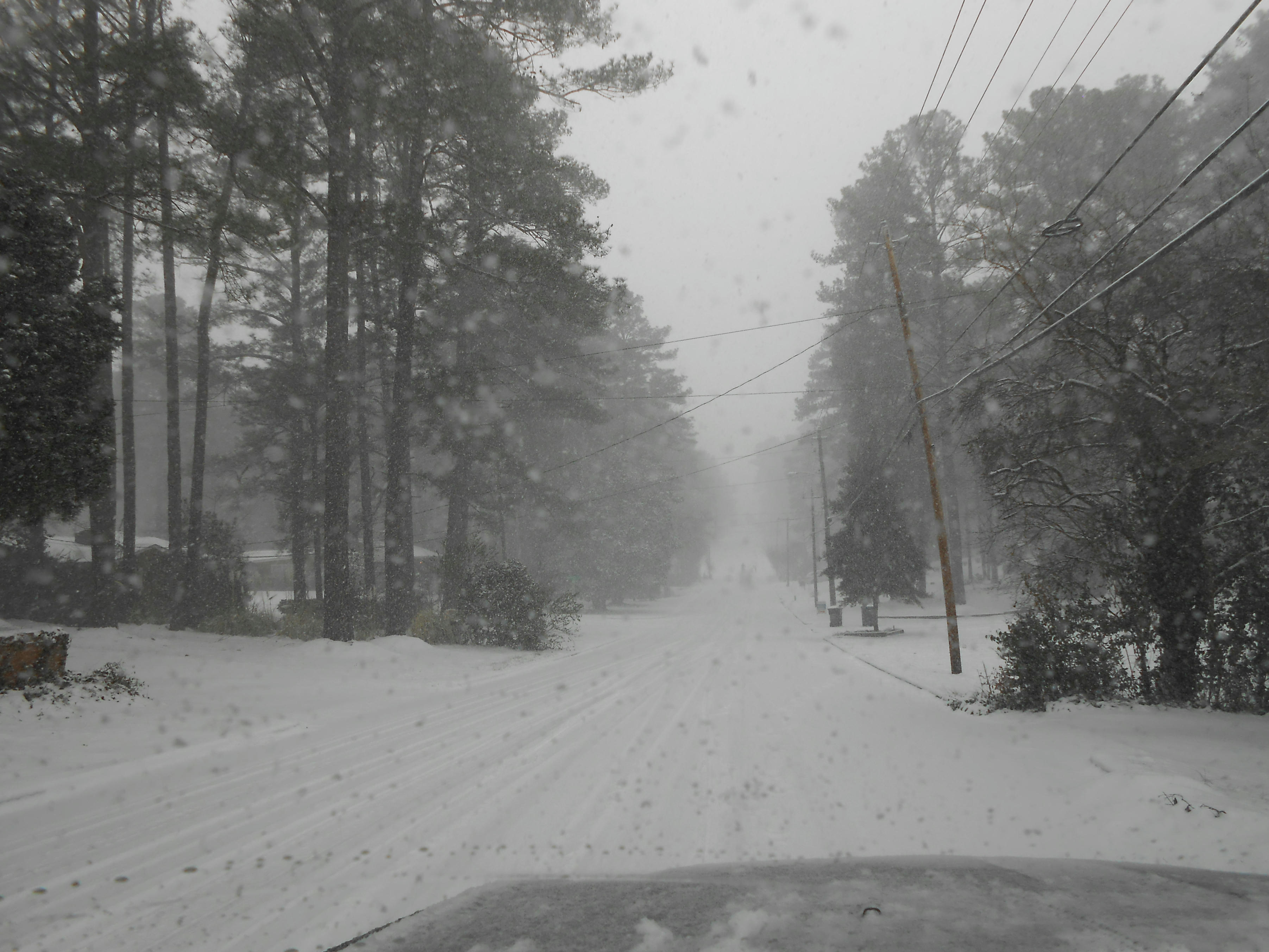

Just wanted to say that I am in central NC, and it was astonishing how quickly the situation went to hell. It was a nice fine clear winter day, with clear dry roads. In less than 30 minutes, the roads were treacherous.
The roads had cold soaked overnight, and the snow hit hard and fast.
This is not long after the snow began:

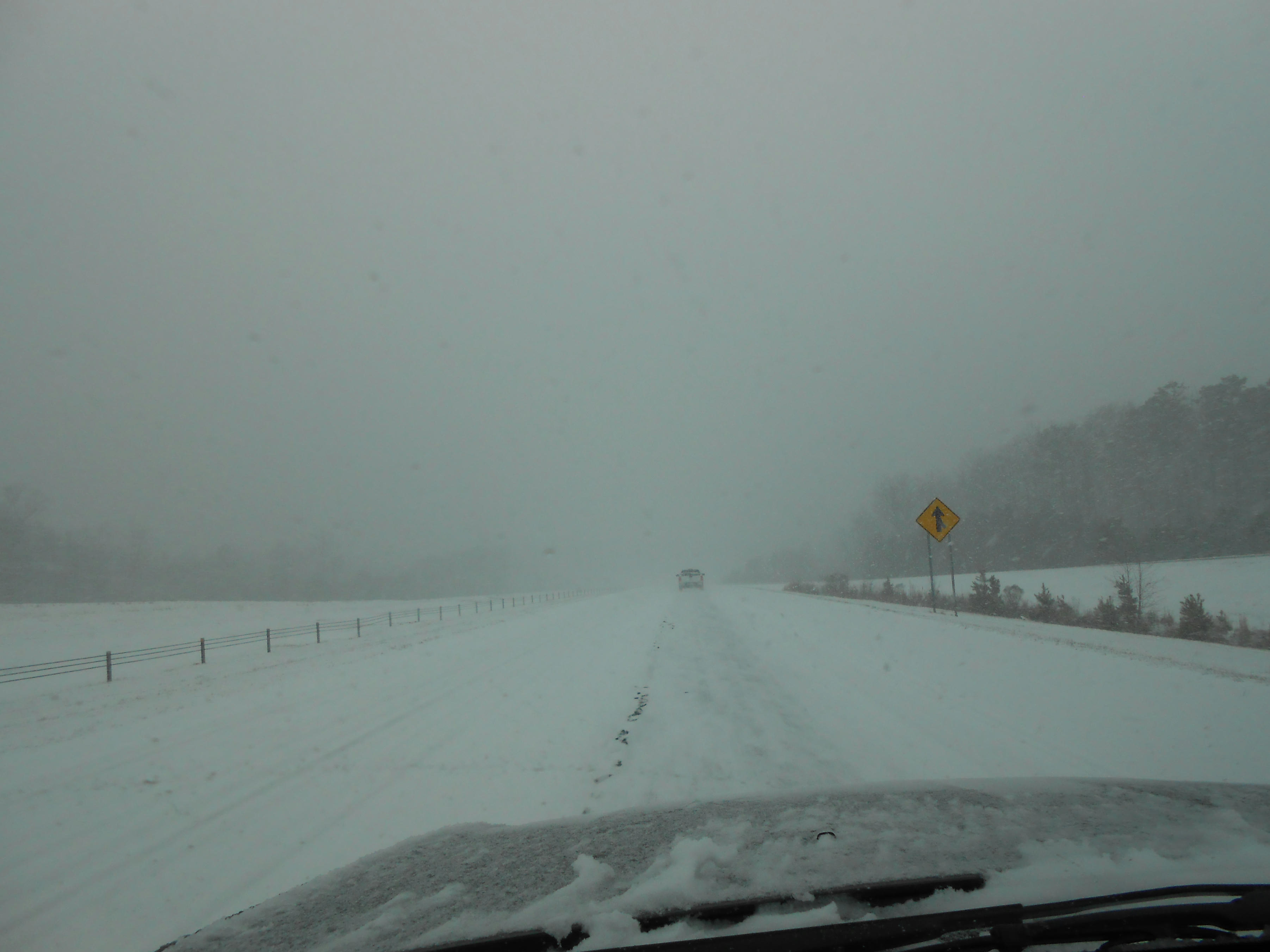

And not much later:
http://www.mediafire.com/convkey/85c2/p83lb2vem9b29mpfg.jpg
