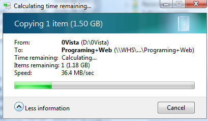

I just got 46 MB/s in a quick test with between my notebook and WHS with a WRT610N in between. That is with old junk cables in between, my new CAT6 cable should be here Monday.
