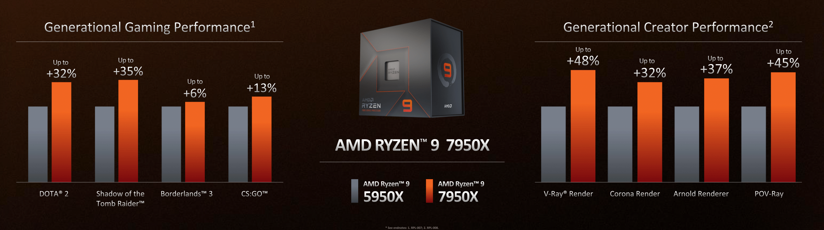

That was a typo but we re talking of the same slide, this one :
Even if the slide notes say that its a 5950X the slide itself say "5000 series", wich imply that it s an average of the whole lines, if it was only about the 5950X then there would be 49% somewhere in the other slide :
Ok, RPL-013 and RPL-014 is the same, so just a typo.

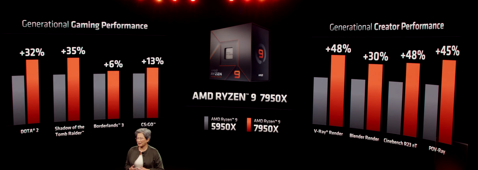

Abwx
Apr 2, 2011
11,940
4,917
I know, but the footnotes are likely also wrong. RPL-013 and RPL-014 are the same thing.
There are a lot of things that are badly presented, FI there are graphs of perfs that werent scaled accordingly, they just changed the names of the loads and kept the same comparison bars , you can see the Cinebench bar at 48% lower than the other test at 45%...
1661816700804-png.1254977
1661816747193-png.1254978
