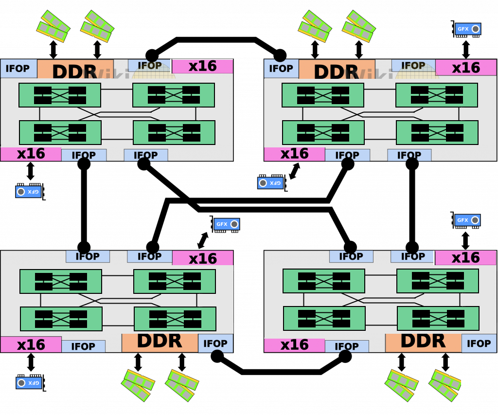

Vattila
Oct 22, 2004
820
1,456
By the way, this is how I envisioned 64-core EPYC:
I am trying to reconcile this with the latest rumour about a chiplet and interposer design. It might be done as follows.
Imagine that this hypothetical 64-core EPYC chip will still use 4 dies (gray) mounted and interconnected as shown (and like before) on an organic package substrate. However, these dies are not monolithic. Instead they are relatively small 28nm active interposers with all the uncore logic, as well as the interconnect for the CCXs (green), which are tiny 7nm dies mounted on the 28nm interposer.
The nice thing about this design is that the 7nm yield would be great, since a single-CCX die without uncore logic would be tiny. Also, they could test for known-good-die on three levels, before testing the whole package (i.e. test the 7nm CCX dies before mounting, and the 28nm interposers before and after mounting the CCXs). This should reduce the test failure rate for the whole package.
For the consumer chips they would just mount fewer CCXs, or fuse off dysfunctional ones that failed testing.
Could it be done? If not, where did I go wrong?
Reactions: Schmide
maddie
Jul 18, 2010
5,155
5,542
I presume they would need some filling material around the 7nm dies, so that the uncore parts of the interposer can make contact with the heat-spreader, for stability and efficient cooling. But this is a general problem for 2.5D designs, I guess.
The nice thing about this design is that the 7nm yield would be great, since a single-CCX die without uncore logic would be tiny. Also, they could test for known-good-die on three levels, before testing the whole package: the 7nm CCX dies and the 28nm interposers before and after mounting the CCXs. This should reduce the test failure rate for the whole package.
Predictions
Stays with 2 4Core CCX = 8 core basic unit as exists today.
No seperate uncore but more L3 cache
Fabric speed increases to accomodate AM4 memory limitations
Improved layout and de-bottlenecking = greater IPC + increased Clocks
More than 4 basic units for higher count EPYC CPUs = 8 x 8C die [64 cores]
EPYC on passive interposer of ~ 900mm^2 [minimal cost increase]
EPYC die fabbed at TSMC process for absolute efficiency.
Ryzen 3xxx fabbed at GloFlo process for higher clock speeds.
LightningZ71
Mar 10, 2017
2,508
3,190
Increasing the number of basic units for EPYC would require additional IFOP connections on the chips and more reservation spots/switching targets in the internal IF uncore of the chips themselves. If you're going through all of that, it's likely going to be no more complex to add two more CCXs to the existing floorplan. While that will definitely up the transistor count, it shouldn't increase the effect beyond the existing 14/12nm true area.
Interestingly, though, if they wanted to, they could keep roughly the same basic layout of the individual chips at 7nm, but move the DRAM and IO controllers off the chip and onto a specific I/O chip, leaving the rest to be essentially CCX and IF chips on the same EMIB/MCM package. So, have 5 chips on one package, four with IF links to the 5th, and the 5th handling all the I/O between the package and the rest of the system. This way, they can change out DRAM controllers, PCI controllers, etc without having to redo the whole chip, or update the package for different applications in isolation of the cores. Having an EMIB/MCM package can allow them to run the IF links between the chips at similar speeds to what they do internally in the chips today. Consumer chips could be a mix of 2 to 4 7nm chiplets, and an I/O chiplet, and maybe contain an iGPU chiplet as well on dual CPU chiplet packages. At 7nm, but maintaining the existing AM4 socket, they'll have plenty of package size to play with for things like that. It would even be possible to integrate an HBM package in there as well. On a desktop product, cooling a package with two CPU chiplets, an iGPU chiplet, an HBM stack and an I/O chiplet would no be unreasonable. With low enough voltage and frequency targets, it could even work on mobile. Intel is already there with KL-G. Their pricing on the product is indicative of their uniqueness in the market and not entirely a product of cost of production.
Reactions: Gideon and Vattila
Vattila
Oct 22, 2004
820
1,456
This is the AdoredTV 5-chiplet hypothesis.
In my design, the 5th chip is the active interposer itself. I guess a ~200 mm² interposer on the tried-and-tested 28nm process should be able to house all the uncore logic with four 7nm CCX chiplets mounted on top. The size of a CCX is 45.5 mm² on 14LPP, and with over 2x density on the 7LP process, it should be down to half the size, allowing for some additional transistor budget for core improvements and larger caches. So these CCX chiplets would be tiny and hence yield well.
Then put four of these interposers in an MCM for 64-core EPYC and Threadripper, two for low-core-count Threadripper, and one in Ryzen 3000 — just as before.
