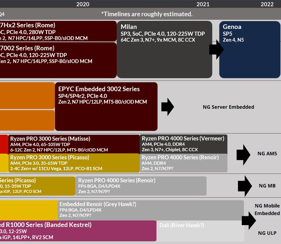

According to this leaked slide we're talking about, Zen 3 will not use either 14 or 12nm I/O dies.

To post a pic from the above-cited article:
Based on that, what do you think will be the launch date for Vermeer? Also remember that the above roadmap has nothing to do with commercial availability (per se); for example, Milan is shown as being maybe a March/April 2020 product in the above leaked roadmap, but we all know that the Big Cloud Boys will be the first (and possibly only) ones getting chips at that time. You'll have to wait awhile to order a small batch of servers from an OEM featuring Milan.
