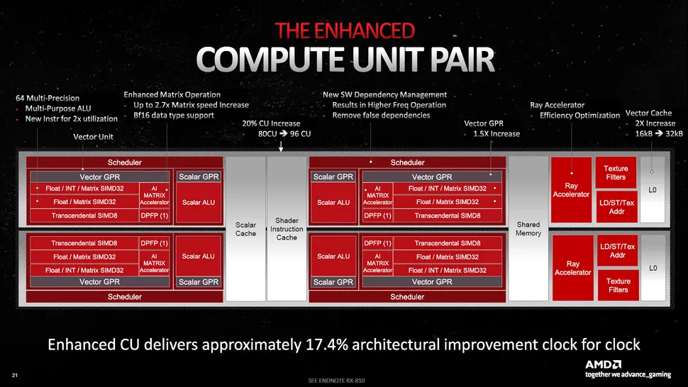

Just look at the specs.
7900XT6950XTDelta7800XT(N32)6800Delta
84 CU80 CU+ 5%60 CU60 CU0%
192 ROPs128 ROPs+ 50%96 ROPs96 ROPs0%
800 GBps576 GBps+ 39%640 GBps512 GBps+25 %
Overall FPS DeltaPer AMD slides+ 30%
If we take AMD at face value that the RDNA3 CUs are 17% faster clock for clock then to hit 6800XT + 30% you need to be about 50% faster than the 6800 at 4K so that would require 30% higher clocks. The 6800 manages to sustain between 2.1 and 2.2 Ghz so call it 2.15. That means overall clocks for N32 need to be 2.8Ghz to hit the desired performance target of 6800XT + 30%.
Even with 30% higher clocks though it would have a lower pixel fillrate than the 6800XT and given a minimum gen on gen gain of 30% you probably need more pixel fill (perhaps not 30% more but some amount more). To do that you need more like + 50% clocks which is 3.2Ghz.
Provided it can clock that high (and AMD did say RDNA3 was architected to hit > 3Ghz and N32 is the ideal die for that to be true) it will work out fine. It it falls short then the gen on gen game will be lacklustre. Good pricing could make up for it but I don't think AMD will want to charge less than $650.
If pixel fillrate is low, then texture fillrate is also a problem. Having only 3 SE is also a problem, just to be on par you need 33% higher clocks.
Texture fillrate:
RX6800XT: 72*4*2250 = 648
RX6950XT: 80*4*2310 =739
N32: 60*4*2700 = 648
N32: 60*4*3079 =739
I don't have high expectation for performance.
To be faster than N21, not sure by how much, you would need >3GHz, and I am a bit skeptical.
N33's specs looks even worse.

You are not considering other factors, like the increased L0/L1 cache, i.e., and other architectural improvements. It depends a lot also on where the bottleneck is. The comparison above, i.e., puts RDNA3 CU vs RDNA3 CU but RDNA3 CU has double issue, giving a performance increase of 17% per CU according to AMD's words (and that is probably calculated on final FPS, not simply on FLOPs). Also, clocks on 7900XT are nominally lower than those of 6950XT. So I don't see why a reasonably clocked (2.7-2.8GHz) 7800XT cannot be on par or slightly above the 6950XT. My bet is on around 5-10% more (-20/25% respect to the 7900XT).
Those improvements you mentioned are part of 17.4% increase, and they are likely talking about WGPs not CUs or maybe WGP sees higher increase, but they didn't mention It yet.
I don't see a problem with adding that 17.4% increase to FLOPs. It looked about right for N31.
If you exclude architectural improvements of 17.4% and clocks, then N32 based on specs is ~1.5x of N22.
6950XT is 69% faster than 6700XT.
If you add specs and architecture together 1.5*1.174 = 1.761, then N32 is 4% faster at only 2583MHz than RX6950XT.
The problem is that increasing specs by 50% doesn't translate to 50% higher performance, so the question is how much performance you loose. The lost performance due to scaling needs to be compensated by clocks.
If the loss is within 10% then yes, N32 at 2.8GHz could be a few % faster.
What I want to point out is that 2.8GHz is just the shader clockspeed, the Frontend will be clocked higher, based on N31 It should be 3050 MHz.
I would like to see 3GHz for shaders and 3250-3300MHz for frontend.
Then I can see It being 10% faster or a bit more.
