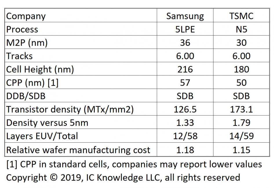

Saylick
Sep 10, 2012
3,506
7,765
AMD is on 5nm... if we were speaking hypothetical in lets ask samsung, it would be Zen4 they make, and that is 5nm.
Samsung 5nm node is a LPE
its not anywhere near designed to make a Complicated A64 processors.
For the record, I don't even think TSMC's N5 and Samsung's 5LPE node are even comparable, at least not on a density basis. TSMC's N5 node is one node ahead of Samsung's 5LPE, which is based on their 7LPP node, and Samsung likely won't achieve density parity until their 3GAE node. Long story short: AMD cannot simply hop from TSMC N5 to Samsung's 5LPE because they are not equivalent. AMD would have to ask Samsung to use their 3GAE/GAP/whatever it's called these days node, which we all know ain't ready yet, and AMD is not going to wait for Samsung to catch up to TSMC.
This article is two years old but it highlights the differences between TSMC and Samsung.

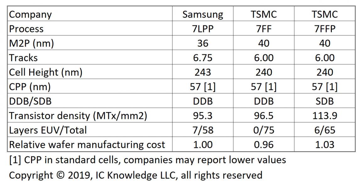

Saylick
Sep 10, 2012
3,506
7,765
I'm not sure why Samsung would even be considered in this instance. Didn't they fumble 8nm? There's some rumor that Samsung completely missed their productions goals and came up way short of delivering product to NVidia and are still having trouble delivering enough workable GPUs. I don't know how true that is but it's something I've been told a few times now. This was before last month's news that Samsung was having yield issues.
I think the original goal was to use Samsung's 7nm family of nodes, but it wasn't ready in time so Nvidia used what I presume is Samsung's 8LPP node (with some tweaks so that JHH can fuel his marketing team's claim of a custom node), which was more mature at the time. Rumors are that the next generation of Nvidia GPUs (the one after Ampere Refresh) will finally use Samsung's 5nm nodes, either 5LPE or 5LPP with Nvidia's usual tweaks of course.
The process is called 8N because it is specifically designed for Nvidia’s use and should include various unspecified improvements and modifications. It should therefore be a better technology than the 8LPP process used by some mobile phone SoCs. According to some sources, modifications done for Nvidia result in up to 10% higher performance (meaning higher frequency could be achieved) than the original version of the process that was focused more on mobile SoCs. However, this process probably achieves lower energy efficiency and transistor density than the real 7nm process, which in the case of Samsung is employs EUV lithography. It’s likely that the 8N process is also inferior to TSMC’s 7nm node.
Source: https://www.hwcooling.net/en/ampere-gpu-deep-dive-whats-new-in-geforce-rtx-3000-architecture/
