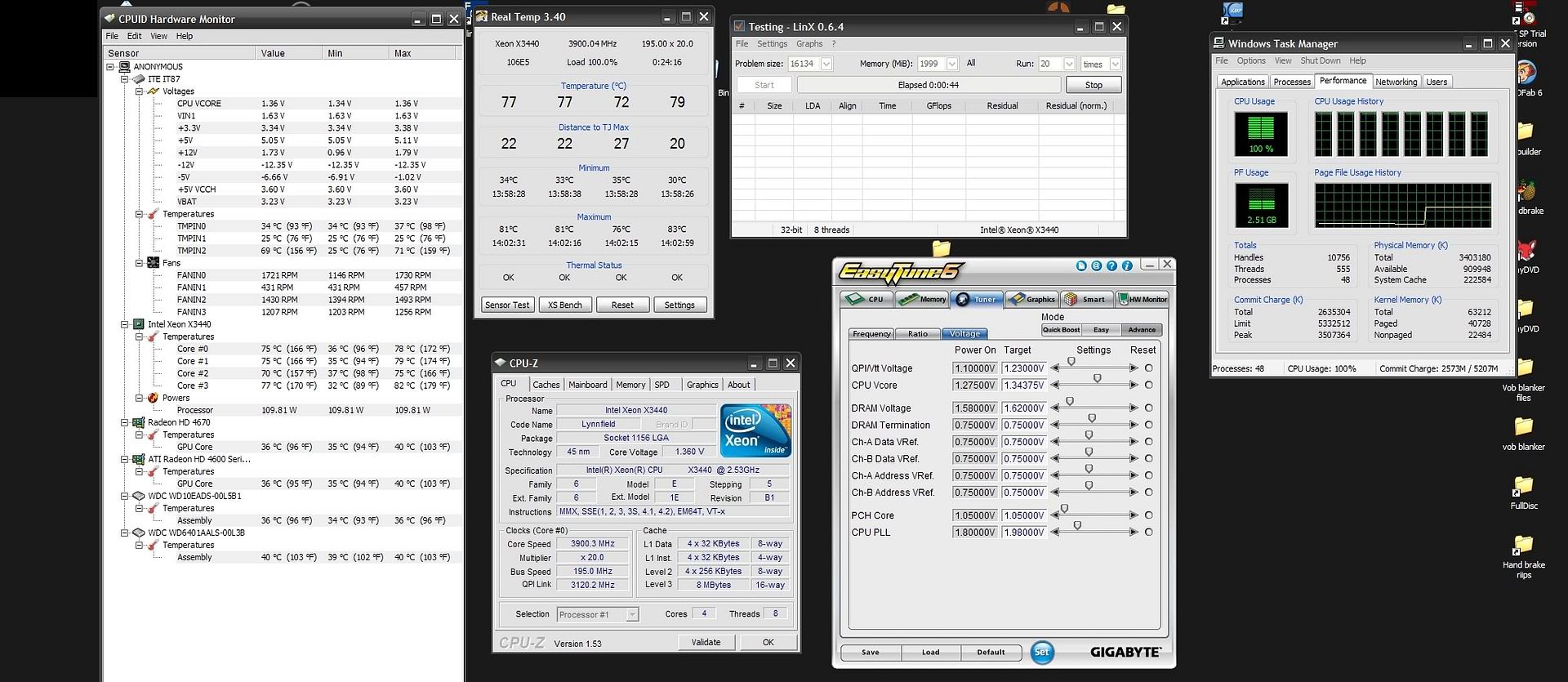

X3440 should be able to hit 4Ghz quite easily. Don't know how hard you'd have to push the Q9550 for it
Getting closer to the time when I need to make a final choice for the mini-upgrade. Can a server chip like the X3440 be put in a regular socket 1156 board? And does anyone have good experience overclocking this chip? Thank you.
