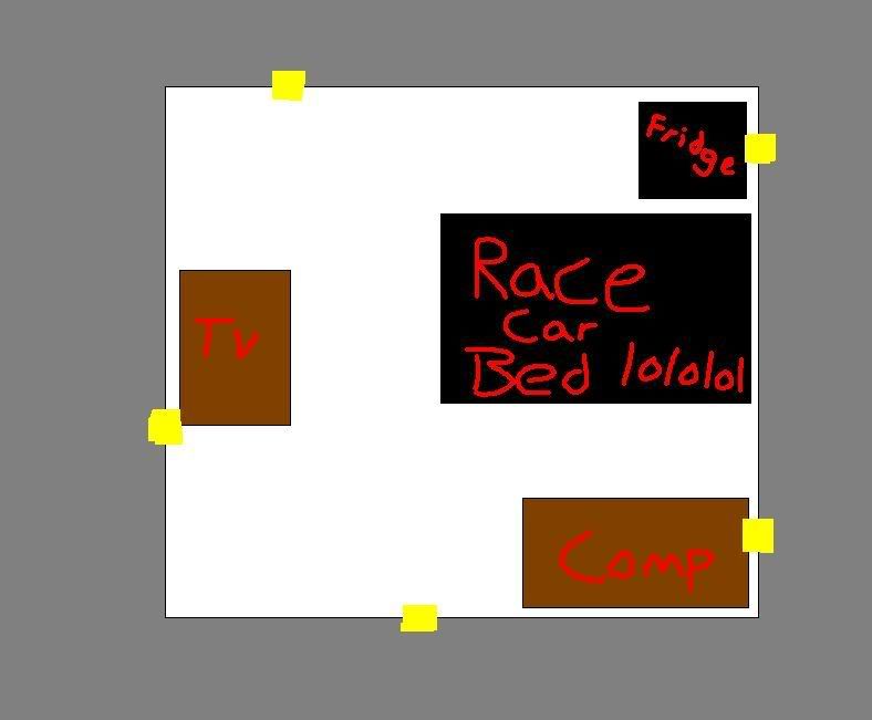

Not really sure where to put this but since it involves my computer speakers and potential concerns regarding my system I figure this would be the place to start.
I recently moved into a new house and this is the way it is currently set up. crude drawing (yellow squares indicate outlets)
The fridge power strip and computer power strip are plugged into the same wall, and when the fridge turns on/off my computer speakers crack. I am assuming this might be a result of the fridge drawing too much power to turn on, and a friend has told me that it could be bad wiring in the house. Is there something cheap I can buy to solve this? Or would moving it to another wall help? I know it's obviously having an impact on my speakers but I am concerned about the monitor and tower as well. Thanks!!! :)

I would try moving the computer or the fridge to a different outlet or wall in the house to see if it still happens (i doubt it will repeat though).

kitchen should have its own circuit. many times its 20 amps vs 15 for other room circuits. move the pc power, not the fridge.

I think this stuff is all in one room. Is it a mini-fridge?
All of the outlets in the room are probably on the same breaker (line) so moving the stuff around to a different outlet probably wouldn't help.
