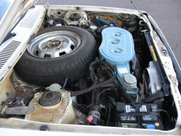

My old Subaru had the spare next to the air cleaner.
IronWing: That spare must have been a real delight to get out-especially if you were wearing good clothes at the time, too short and/or weak, etc.

I owned a couple subaru brats with the spare in the same place. It wasn't bad, plus the tire is a 14 inch one IIRC so its not that heavy.
