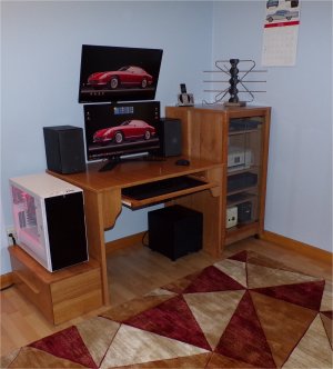

The battery compartment of an SUA750 is walled off from the transformer, and the front has no vents, so there would be 0 airflow from a fan there.
I am not putting two battery boxes in my office:

Yes the battery compartment is walled off. You mod it, add intake and exhaust area. Not a big deal, use a drill and make several little holes and/or a larger hole saw, but it's a non-starter without the space for the larger batteries. Well, not really, given adequate motivation you could just build a box that sits under that cabinet the UPS is in, but I can appreciate not wanting to put forth that much effort if your power outages are not long and frequent enough to bother.
The fan is needed to cool the transformer, which is in the back of the UPS. I assumed that's what you meant by mounting a fan in the battery compartment. It's the back portion of the UPS that gets warm when on battery power. It does have ventilation on both sides, but no fan.
There isn't enough space under the cabinet for battery boxes, and even if there were, how would you access them? There is also the concern of Deep Cell batteries off gassing inside my room/home when charging.
Plenty of runtime now with the SUA750, about 80 minutes,. The computer is all that is plugged into it. Probably longer with higher ah rating of the CSB's.
The white UPS is a 600VA. 450 watt unit, that's running the monitors, router, modem, and phone. After the computer monitors are off, it will continue to power the internet/phone for hours and hours. I've never had an outage long enough for it to shutdown. The load is less than 50 watts. 90 with the monitors on.
A fan doesn't have to be directly blowing on something to still move enough air around to keep temperatures in check on something designed to run passively, but when doing a mod like that, it is still the burden of the person doing it, to compare before and after temperatures.
Space under the cabinet could be made by just building a simple box out of wood, same width as the cabinet, so the cabinet just sits on top of it. Off gassing depends on the battery type. The batteries you already had are the same type as you'd get, sealed deep cycle. All UPS lead acid batteries are deep cycle. Same thing, just higher capacity so they don't as deeply discharge which greatly increases their lifespan in an application where they are being deeply discharged. Similarly, setting the UPS to not run as long using the same/original batteries would also provide some of that benefit (if they weren't worn out). Additionally, if the UPS is trickle charging the batteries and this is excessive and degrading the battery lifespan, the same trickle charge rate on a larger battery, decreases the effect.
That cabinet is on wheels, and it needs to be that way, or you can't move it. The whole desk setup was custom built to my specs by my FIL. I like it just the way it is.
