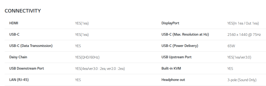

here are the relevant spec:
if I'm reading this correctly, I connect the keyboard and mouse to the ver2 downstream port, the usb-c cable to the laptop and the usb upstream (I assume it is indeed usb-b) to the desktop?
how do I switch between the laptop and the desktop? using the input feature?
Exactly. More clearly:
  • Laptop
    • Connect via USB-C > carries video + USB data + charging (65W).
    • Your laptop will see the monitor and the USB hub (so kb/mouse plugged into monitor work here).
  • Desktop (workstation)
    • Connect video via DisplayPort IN (or HDMI if you prefer).
    • Run a USB-B upstream > USB-A cable from monitor to desktop. This is what gives your desktop access to the monitor’s USB hub (your kb/mouse).
  • Peripherals (kb/mouse/etc.)
    • Plug into the USB downstream ports (doesn’t matter if 2.0 or 3.0 for kb/mouse).
Yes, you switch via the Input Source control on the monitor (OSD menu or joystick button). When you switch to USB-C input, the monitor routes the USB downstream ports > laptop. When you switch to DP (or HDMI) input, the monitor routes the USB downstream ports > desktop (via the USB-B upstream link).
