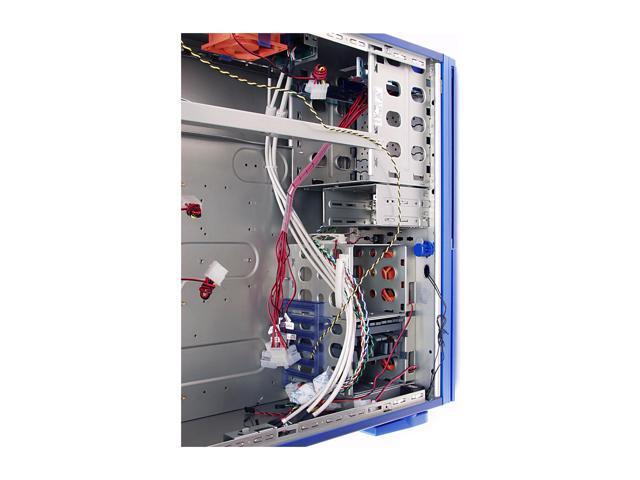

So...here's what I'd recommend. I'm taking it your case's inside looks like:
This
Now, my image will not completely match up with what I'm saying. It is just a visual aid of how to fold the cable, not to place the drives.
my pic

If they are going on the same channel, have one WD SE ins slot 3, and other in slot 5, with the cable pushed into slot 4 (see pic). If separate channels, have one is slot 2 or 3, the other in slot 5 or 6, and just do the bending around the cage part, maybe with a tab of foam tap for them to stick to in the case (or those little stick-on clips OEMs use that are hard as hell to find).
This will get the normal PATA cables out of the way. Then put the 20GB in another bay (maybe above the floppy or under a CDROM) with the SATA converter. The 20GB should be fine that way, but the 120GB SEs will get very, very hot stacked together with anything.
On the overheating, with a little space and some airflow, they will cool fine. I can't tell by the pics at the egg whether or not there are front intake fans. If there are, you'll be fine, as drives do need cooling, but not much (with ideal cooling, like the Antec SLK3700 or Evercase e4252 offer, you only need an exhaust fan going...I;ve never used a Xaser, though, nor the case (Enermax?) it is based off of).

http://www.overclockercafe.com/Reviews/cases/Tt_Xaser_III/1023.html
If you've got that thing, you're set, just get the cables folded so they go through that. That's one of those clips I was talking about.
