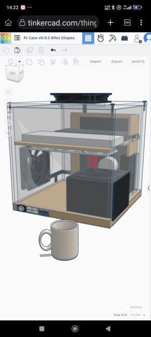

Back when I was a teenager building my PC in a ThermalTake Mozart TX case, I was excited to use a rheobus and a Shutdown Power Protector. I thought it was genius to keep the fans running after shutdown, believing it would protect my overclocked system from overheating.
However, reading about thermodynamics now, I realize that setup was counterproductive.
But, what lead me here is that I'm currently building a fully custom PC case built to be cooled by an Air Conditionning Unit, which would be pushing cold air through a duct into one of the side panels, which would then be exhausted from the top panel.
The case would be divided into two compartments to guide the airflow through the GPU fans, and through the CPU AIO's radiator.
I've seen many videos of Youtubers trying this for fun, but I'm wondering if anyone has ever done this as a daily.
I'd also like to have the AC unit be managed just like any PWM fan by the motherboard Smart fan curves.
I have been trying this on my current PC case, an old HAF500, which has a partial mesh side panel and is quite appropriate for testing purposes.
I've been able to reach single digit temperatures in mid summer, but I was playing with luck, a wine hygrometer, and full negative airflow (all fans switched to exhaust only) to prevent humidity.
I'm wondering if the Power Shutdown Protector would be appropriate for safe shutdowns in this specific setup, either for the exhaust fan, both exhaust and intake, or only on the CPU AIO pump and fans, to prevent any humidity from building up inside the case after shutdowns.
Cheers.
