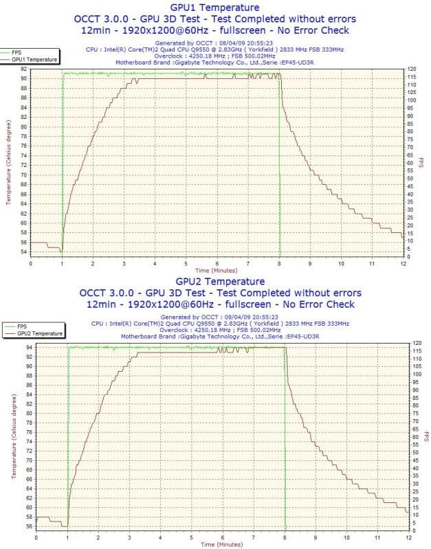

It definitely gets fairly hot on that side if you've ever tried to put your fingers there when its working hard. I've often thought about letting a 90mm fan lie there and see what differences I get. Give me some time and I'll get back to this thread. Keep in mind I'm running a dual gpu card however.
edit: Doing the before temps, got the fan off my old pc.. results in half an hour
Results

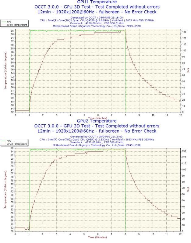

With the fan placed to blow directly downward upon the gpu of the 2nd card, temperatures actually increased noticably across both gpus. Not so good.
The Fan (it was mounted using 2 elastics and 4 twist ties to an athlon xp)
Temps Without Fan
Temps With Fan
I imagine if you were able to push cold air across it, it may help. But clearly just dropping a fan there and letting it go is counter indicated.

My results above would make me think if you want any cooling on the solder side of the card, you're gonna need a heatsink or something, as having a fan blowing on it didnt help, but hurt. If you don't think that makes sense, try it out yourself with an extra fan. I imagine results will be similar but maybe a case with low airflow might have some benefit.
