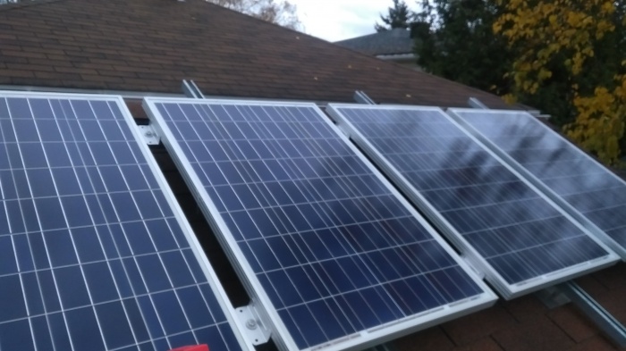

California has a 30% rebate and it starts going down after this year. I had to move my family into a larger house end of last year, PG&E bill in the winter (with MIL at home all day, got over $585 a month), the AC units were the oldest I've seen and knew I had to replace before summer. The rule of thumb is don't get solar unless you plan on living in that house for 10 years. I looked at paying PG&E as money out the door, at least with solar it's going to something tangible, increasing the value of the home AND the monthly payment on the loan for solar is less than most months that require conditioning.
After doing some research and getting bids, I had a 10.4kW system installed for $29k (ended up being a little more out the door because I financed, NOT LEASED), but no one could come close to this $ per kW.
Still waiting for PG&E to come out and OK it so I can start selling power back to them, but for now, during the afternoon while just one AC unit is running I'm still power negative. The amazing part was it only took them two days to install.
Racks:
Finished day 2:
Reactions: Kaido
