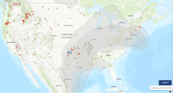

5) Wattage ratings are typical maximum ratings*. Meaning, unless things are perfect, you will get less than the rated power. So, if you need 40 W of power, a 40 W panel won't cut it even on a blue, sunny day. Things you might not even think about will lower output just enough to notice. For example, you might not see any clouds but you might be underneath a plume of small wildfire particles. Here is the current map.

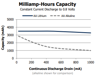

Regarding the Lithium ion batteries, why are so many places showing them rated in milliwatt hours, rather than milliamp hours? When I did a conversion, they come across with a lower rating than the old NIMH LSD batteries. I thought they were much more energy dense? From what I see, it doesn't seem worth paying 3X as much for them. Any thoughts?
I don't know exactly why there is a change in specifications, but mAhr was always a highly misleading measurement. That is because the capacity depends on the type of use. There is no one capacity rating for a battery--but they still list just one on many batteries. The end effect is that you can only use mAhr when comparing batteries of the exact same chemistry for the exact same type of usage.
See below how the mAhr capacity of an alkaline battery changes drastically with the drain applied.
From here: https://data.energizer.com/pdfs/L91.pdf
There also isn't just one lithium chemistry. There are quite a few that are readily available. So any generic trait like "energy dense" may only apply to one type of lithium battery. Generally lithium batteries are lightweight, work well in more extreme temperatures, and have a long storage life. Capacity, actual weight, energy density, and fire safety vary drastically from lithium battery type to lithium battery type.
