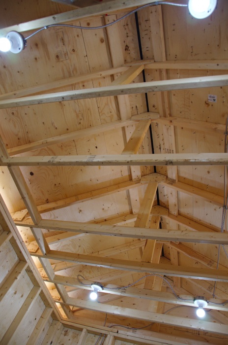

I just ran some normal 120v light sockets in mine and put LED bulbs. Runs off a 350w inverter. Right now the solar panel is just on the ground but I bought some bigger ones that I want to roof mount. Just trying to figure out the best way to go about it. It's hard to buy solar stuff here as there's not really any place to buy it so I have to custom make everything.
Downside with this setup is that the inverter does use power even on idle so you need to size the battery decently and account for overcast days. I think what I'm going to do is put a switch for the inverter near the door too, so I can just turn it off completely if I don't have any other electrical loads that need it. I eventually want to get an electric lawnmower then I can just set it to charge in the shed. Carbon neutral lawn mowing. :D
If you don't have any 120v loads you can also use RV lighting and just run it all off 12v.
