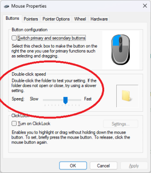

Hmmm! I've always been able to control click/double click speeds in Control Panel/Mouse. That doesn't work?

No, that setting only lowers the threshold to allow slow double clicks (as you move it towards 'Slow'), but it doesn't filter out the fast ones.

Is there not a click speed setting in mouse properties in all Windows since forever?
The old Windows PowerToys for W9x ~ XP used to have such a setting specifically to detect accidental double clicks. Not sure if the new PowerToys still does?
