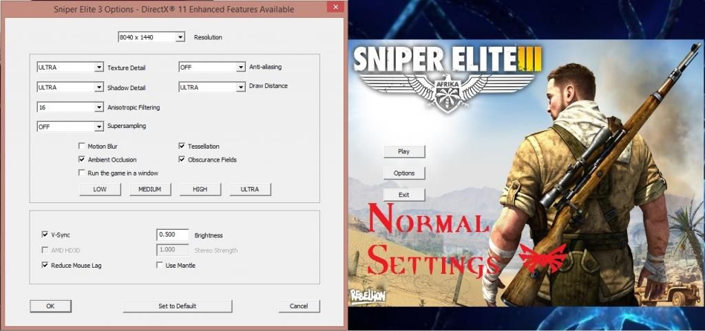

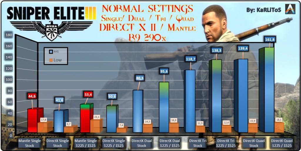

NORMAL SETTINGS
NormalSettings_zps5485b699.jpg~original
SniperElite3NormalSettingsComparaison_zps2736a292.jpg~original

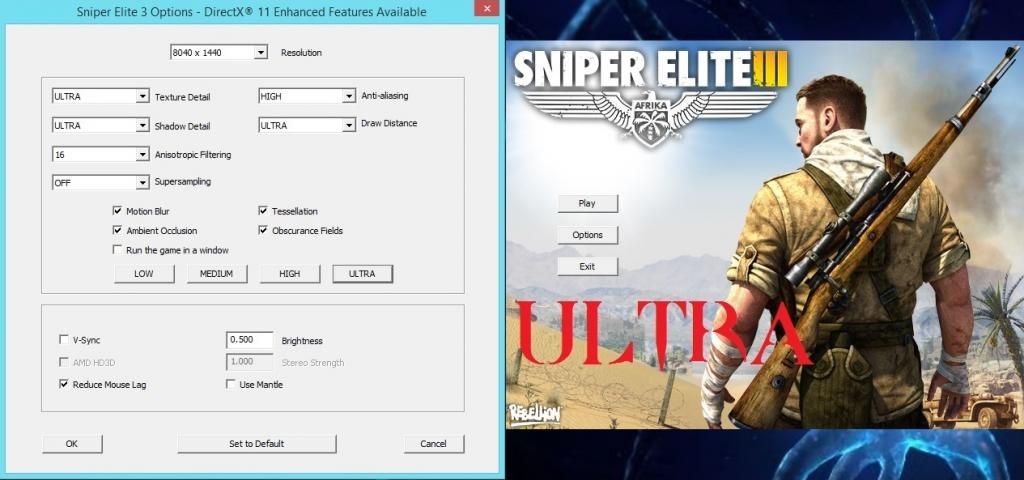

ULTRA SETTINGS ( Anti-Aliasing High , supersampling off )
Ultra_zps0ce2d55d.jpg~original

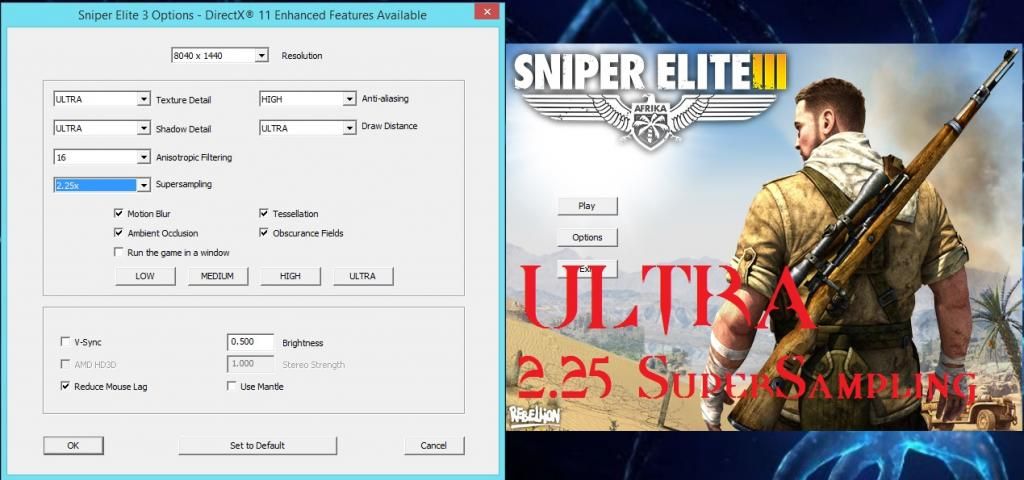

And with SuperSampling 2,25
Ultra225SuperSampling_zpsdd486926.jpg~original
MantleUltrasettingcomparaison_zps09cec41d.jpg~original

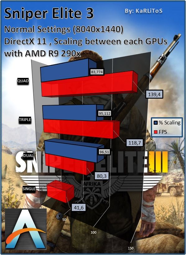

Now the scaling between each GPUs (This is very good scaling)
Scaling_zps1745b296.jpg~original

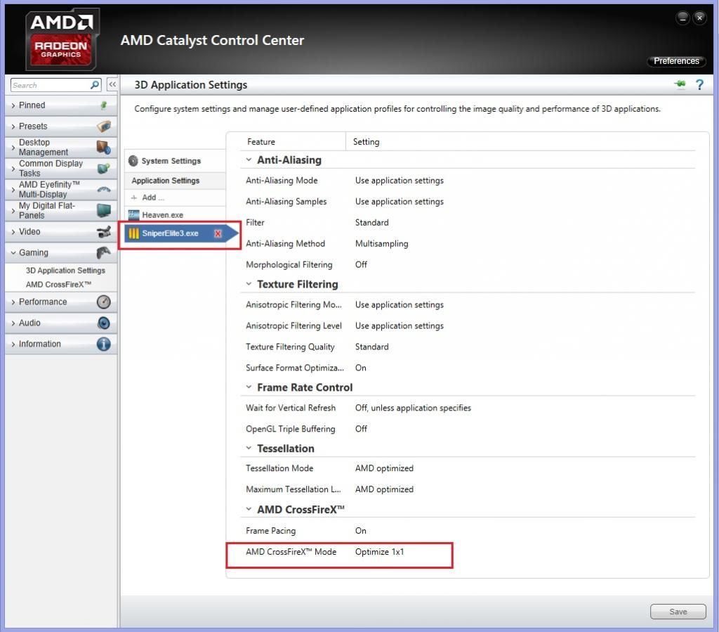

NOTE: I had to force Optimize 1x1 for the crossfire profiles for the 3rd and 4th card to be utilized. If I didn't do that, it was max 2 cards utilization.
CrossFireProfile_zpsafac252a.jpg~original

Wow, those minimum frametimes are impressive for Mantle. From 10fps to 18fps, that's a good improvement.
Sucks about the broken Crossfire though.

Hey guys, I tested the same bench as the normal settings one, with a resolution of 8044x1440 with my i7 4930k @ 2.4 ghz and the results are exactly the same.
Same percentage difference.
