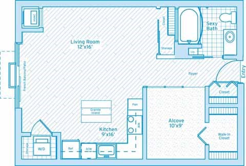

this is all in a 25'x35' basement and works great... hangup is the new apartment is less square feet than my current basement.
Anyone have a clever way to get the TV and Projector utilized in the living space without looking like trash (must pass wifey approval)
New apartment layout :
500
* Forgot to mention- current idea*
My current idea is to have a low rising tv stand that the TV would sit on (upper wall of photo above ^).... above the stand (there are 12' ceilings in the apt.) have some ikea "floating" cabinets, then cut a 88" x 3" hole in the bottom of the cabinet then a motorized drop down screen would come out come of cabinet through that hole (would hide the screen and cords from the Mrs.).... and hopefully (haven't measured yet) the screen would stop ~6" above the top of the TV screen.
I would have the projector hidden on top of the cabinets in the kitchen so I could get a full throw needed to fill the screen.
My buddy does setups like these in NYC. I don't have any pictures handy, but basically they make a build-out cabinet from the wall (basically a floor-to-ceiling rectangle that sticks out a foot or so) and house the TV in the middle (rectangular cutout) and have an electric screen come down. So during the day, you get TV viewing, and at night, the screen drops in front of the TV and hides the whole thing for big-screen projector watching. It's really an awesome setup and ideal if you can't get light control during the day, plus it looks really classy.
You can get fancy and add can lights in front of the screen, hydraulics for a TV lift, hide all the wiring and electronics in the cabinet, wall-mount the TV to the rear of the cabinet, etc. If you don't want to invest a lot in it, simple MDF works great with either paint or vinyl as a finish. If you want to go faux the easy way, check out Orbi vinyls on eBay - they take awhile to ship from China, but they look really nice and go on with a hair dryer: (I use them for DIY speakers)
http://stores.ebay.com/ORBI-Vinyl-Supplies
So you could make something pretty awesome without a lot of effort. If you're looking for electric screens, here's a link to one of my forum posts:
http://forums.anandtech.com/showpost.php?p=33890521&postcount=16
I got that $130 Elite screen a few years ago, works great. Has a remote control.

What makes your new bathroom "Sexy"
In seriousness...
I think I would consider dropping the projection and just go with a standard TV on the top wall.
Why the big lifestyle change?
That's cool, but sadly most people just renting a place can't pull it off.
I'm not really a big fan of complex electronics for simple things like that. An electric drop-down projector screen is OK, but a lift-up TV stand is much more complex (not to mention expensive) and while it has a cool factor...not for me. I'd rather just wall-mount the sucker and be done 😀
