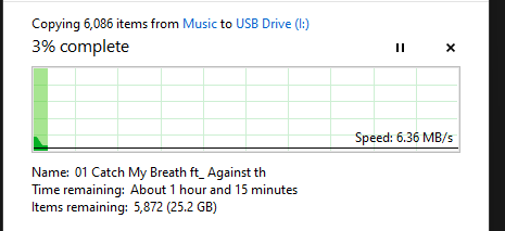

I've got an SD extreme and it works fine. Mind you it's the 3.2 version. Did you try a different port? IIRC the one I have is 256gb and does 400MB/s and acts like an SSD and not just a flash drive.
https://www.amazon.com/dp/B081DFPN3T this one still manages 75MB/s
https://www.amazon.com/dp/B01N7QDO7M this one is the faster one.
I use the slower one for ISO boots and the other ones acts as a portable windows image of my current setup.
another thing to note is the speed of the source. If it's slow then the USB will be as well. The types of files makes a difference and the utilization of space impacts how fast things will go.

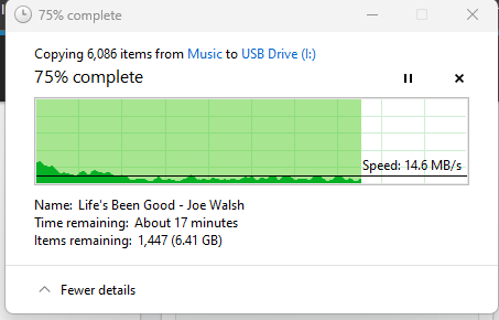

Sounds like a bigger hub with more ports might be useful and just plug everything into that with the best working port. As to the port not working it is probably loose cables on the header side on the mobo. If you go for the bigger hub it might be worth considering a USB card to boost your bandwidth and add a couple of ports.

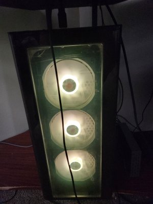

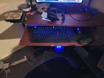

I use side tables that are 24*24 or bookshelves. Just something to get things off the floor. Then again I'm using mine as a headless server and not a workstation. Tables and bookshelves are cheap. Desks are usually cheap material but expensive to buy.
Yeah well sometime if i had to i guess i could look into side table, provided all the cables would reach if i did move it to a Side Table.
Keeps it in mind as an option though if i can't afford newer desk at some point
I've used this one for a few different things now. It's a good platform for different gear. Very sturdy for heavy items like the server. I had a projector on it recently along with a soundbar.
Cabling is easy enough to overcome though. 10FT HDMI cables are only $10 even with 8K ratings. If you get a little creative in how you setup things it sometimes works out better than the traditional setup. Get the heat / noise away from your work space and keep the dust out.
For the bookshelf it's just an Ikea one and used it as a TV stand for quite awhile with it on its side.
