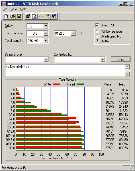

ATTO is a quick & dirty file-system level sequential read/write benching tool.
You can find it through here:
http://kb.ciprico.com/lore/article.php?id=268
Here are some of my setup parameters and results for example:
http://i89.photobucket.com/alb...tto-random-network.png
One sure way to run Intel RAID 5 would using a Windows OS, where the drivers and utility work for sure. I don't know if it's possible or recommended within FreeNAS -- you'd have to find supporting drivers for that. You'd probably be better off researching FreeNAS's RAID 5 implementation instead, notably for write caching. Write performance issues should show up in the ATTO results.
