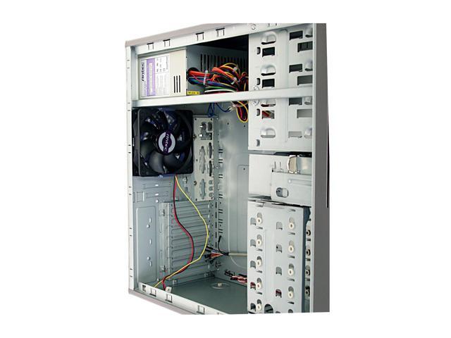

I'm building my first computer and right now it's just a paper design. I want to put a 2800+ with NF7-S into the Antec SLK3700AMB because I like the dual 120mm fans feature of this case. On top of the CPU will sit an SLK900A with a 92mm Panaflo. It just dawns on me, that's a hugea$$ heatsink with a big fan sitting in the vicinity of a hugea$$ case exhaust fan. Is there any chance that there can be a collision between these devices? Thanks.
Picture of the SLK3700AMB

i have that case, and looking at your mobo online, you should have enough room. on another note, make sure you cut off the pre-fabbed grills on the case, although they aren't the worse, they could be better.

Although the SLK900A is rather large, there shouldn't be any cases that will not accomodate it other than maybe those small form factor cases.
