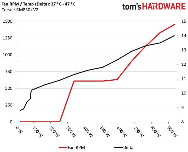

Of course it depends on the unit, but a heavily loaded PSU is less efficient, runs hotter, and is noisier.
Also from the review you referenced:
