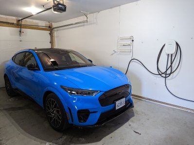

It's not hard at all especially if you are somewhat familiar with wiring. I know you are just thinking about it but IMO the Emporia chargers are the best bang for the buck on the market right now.

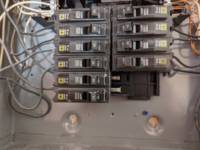

I hardwired one in a few years ago on a 60 amp circuit and it has been rock solid. It set me back $400 for the charger and around $400 for all the materials to install it myself. The wire was the most expensive part but I had a 125 foot drop. If you have the skills and it's closer it would cost a lot less.
Here it is just after I got done doing the install.
The last blank in the subpanel is were the 60 amp breaker was installed.
