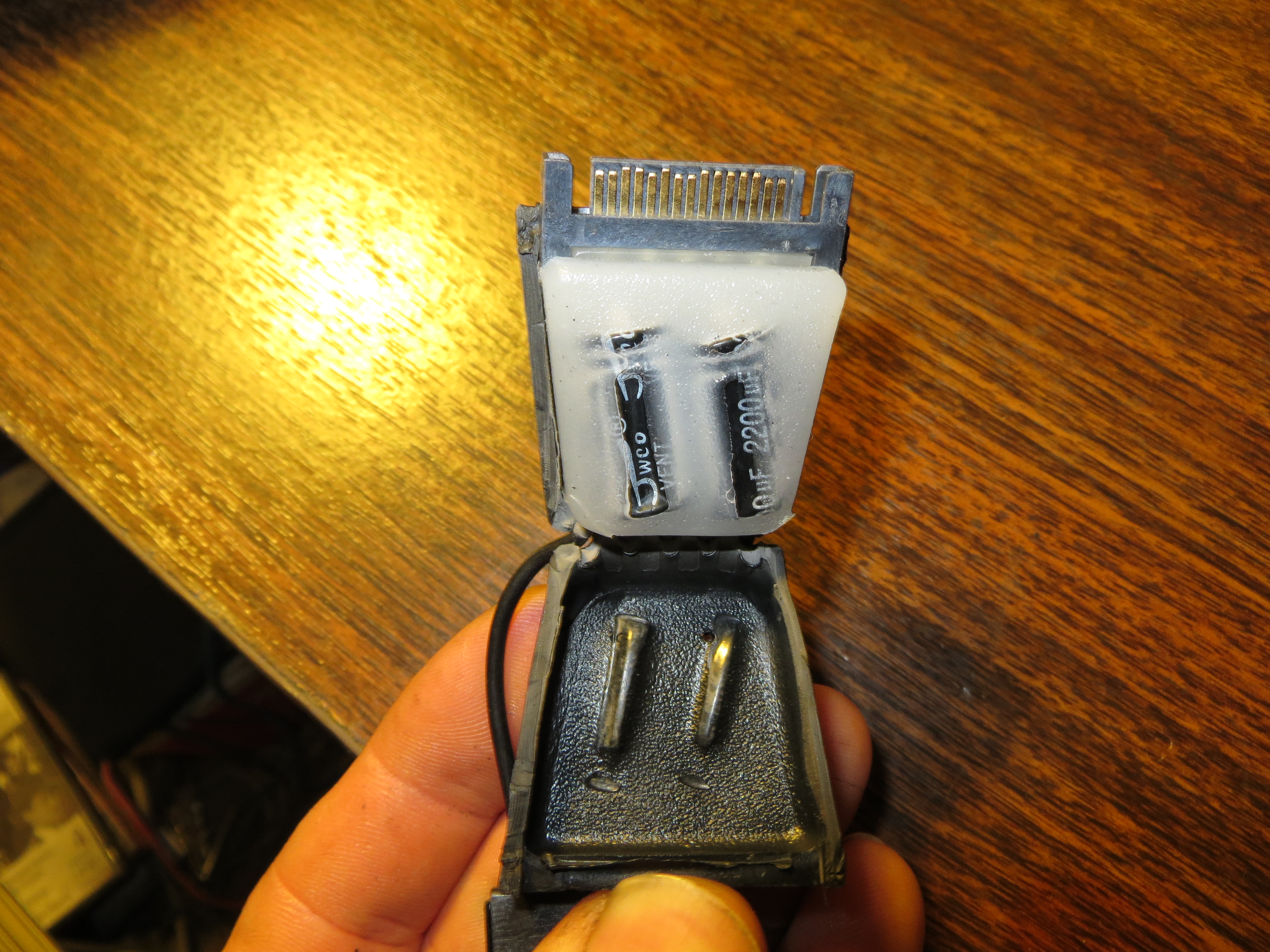

"Includes two 2200?F capacitors for stabilizing +12V and +5V voltages"
Are those two caps potentially drawing enough power to overload the psu ?

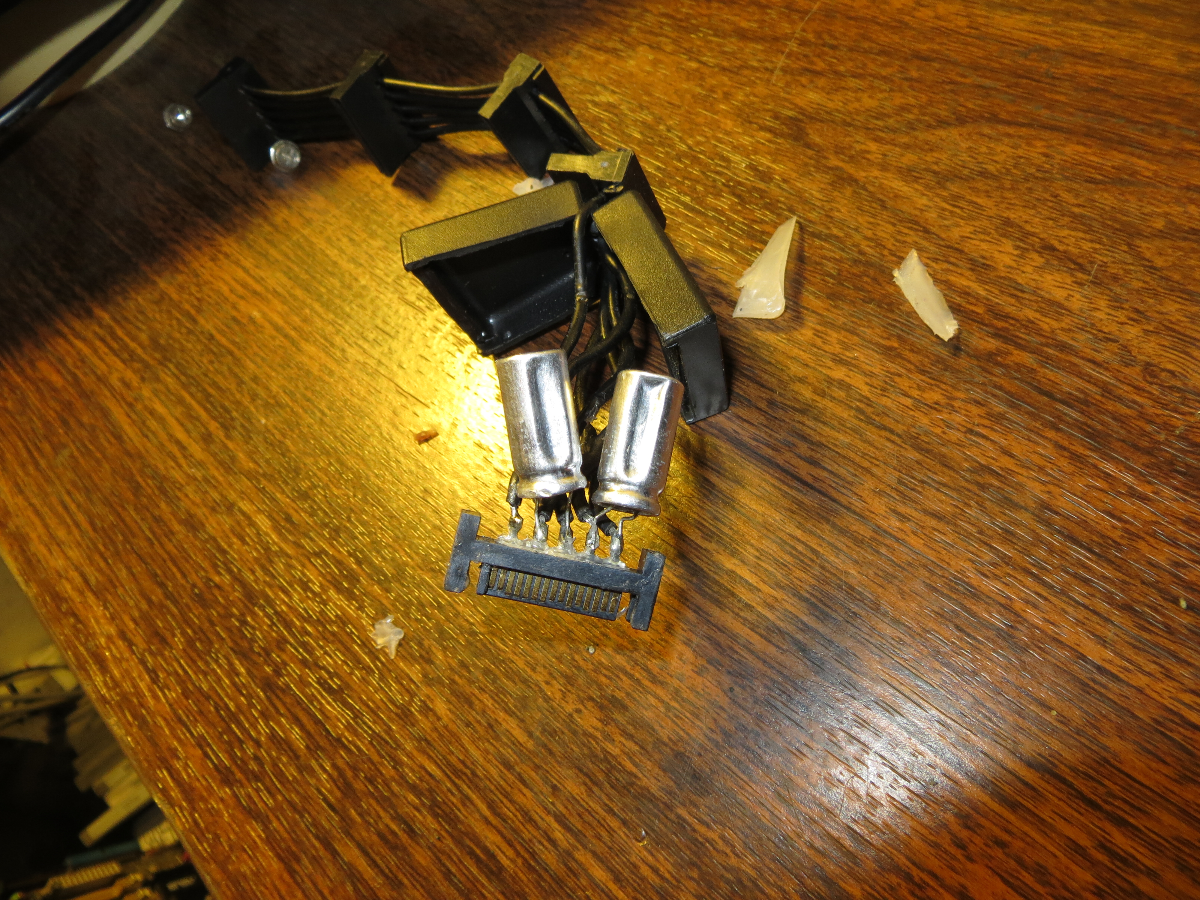

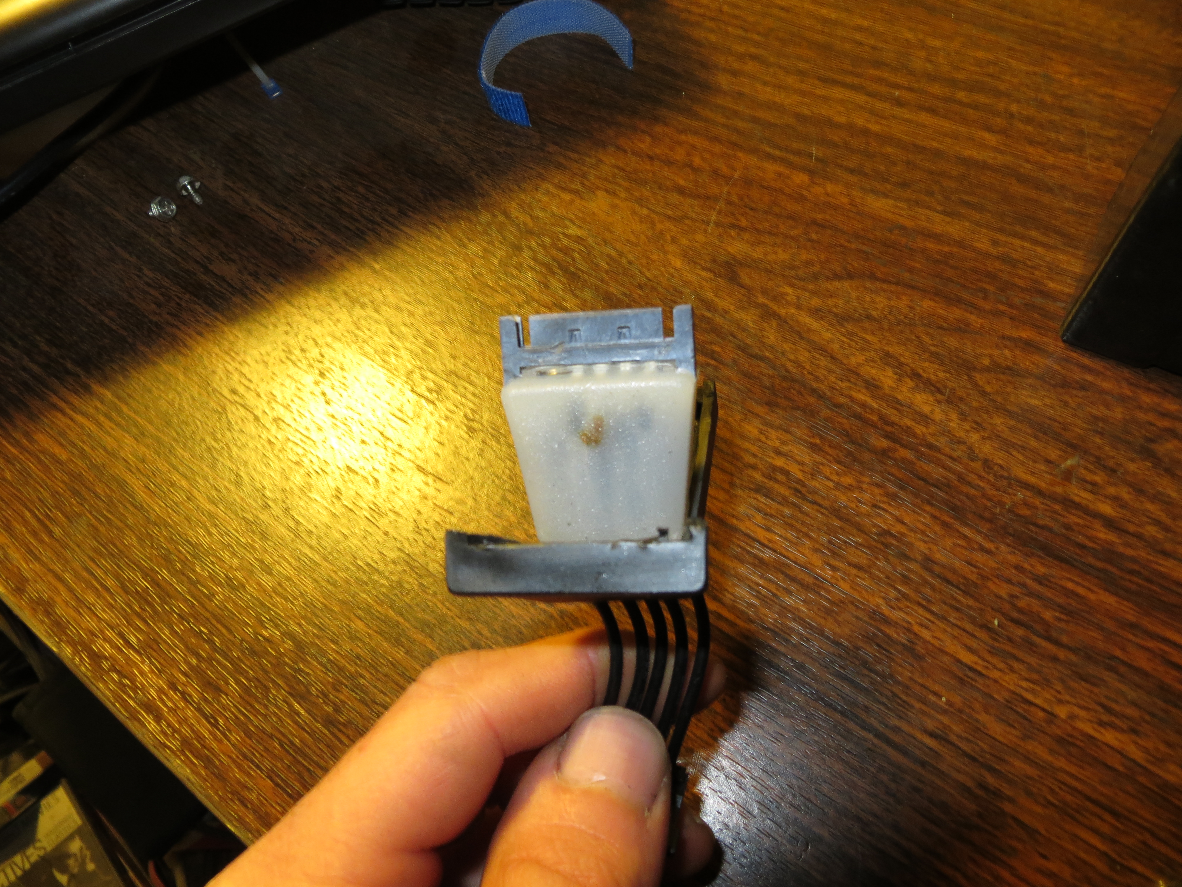

I'm more likely to open it up and remove the capacitors.
I'm wondering how much current those caps will pull while powering up. My electrical/math skills aren't enough to calculate that :(
