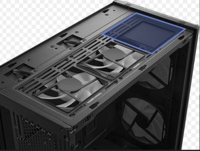

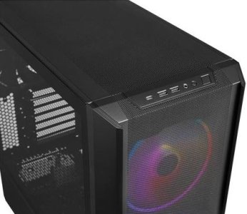

I just built a new computer, and there is a couple of extras I got that came with the mobo. One of them is what they call a "Seal Plate for Optimized Airflow." It attaches to the front top, as shown in the 2nd image below (highlighted blue). This seems to be for if you hook up 2 extra fans on the top mid and rear (which aren't included), which I don't plan to do. Those two big fans in the front that are already a part of the case give plenty more than enough air flow.
I was wondering if I should still put that plate on the top to prevent dust from settling in through the top grates, or just go without? The back two brackets where the fans go are right above where the CPU fan is, so I'd imagine dust getting in there would be less of an issue.
That is the only thing I don't like about this case - all the mini-holes in the top of the case that will let dust settle in there. They only have one of the brackets, so I couldn't seal up the other two unless I got some kind of additional brackets from Lowes or something that would fit it. Not sure if I should bother though?

My daughter has had this case with the stock fan configuration for about 18 months. We did not install that seal plate. We don't have any trouble with dust coming in through the top.

I could see one other potential benefit: less air going out that front top space before it hits the components.
I have found in my Corsair 4000D, I still get dust slowly settling in some spots, despite the intakes all having dust filters, and the top also having a dust filter. So I could still see the closing off of the opening useful on that front.

Thanks for the feedback from both of you. As far as it being useful for air flow, I see what you're saying, and I was thinking that earlier as well. Forces the air towards the mobo and other components before it can go anywhere else. Might not make a huge difference, but it'll only take a min to screw that thing on, so I might as well.

AFAIK the seal plate’s function is to prevent hot air that was thrown out of the case from getting sucked into the case again. Phanteks implements a similar plate in some of their cases to be fitted either in the top front or top back if 2 fans or 2 fan AIO is fitted. If you have top mounted fans or AIO use it, if not don’t.

I know what you mean but things are ever changing. Now you have chipsets like the X670 which is basically a two chip solution and you have all this high speed m2 slots that could generate more heat than you expect. There are boards out there with 4 or more of these slots and for some, cooling a system becomes more of a challenge.
I’m planning my next pc with at least four m2s and I will start with three installed from the beginning so cooling is getting more important than before.
Yes, and all the passive perforations countermine that, reduce the effectiveness and amount of flow front to back, but to be frank, seldom is it the bottom of the back that needs any airflow. The PSU may be there in newer cases, but then it has its own fan.
Not so seldom I am afraid. Nowadays people use risers for graphics boards and m.2 slots can be found at low places on the board. Dual graphics is still a go for some and the PSU may suffer a bit if all it can get is hot air from within the case.
I am currently looking for a case that will allow direct air flow to my PSU just to be on the safe side and not have to worry about summer’s high temps.
It is true that it makes more sense to make the top an exhaust point than intake in most standard ATX setups, but also makes more sense to not use the top at all, if the system isn't struggling for airflow.
I don’t know if it does makes more sense to have it as an exhaust. With all AIO madness I guess it does for many.
Personally I am a fun of versatility. I like cases that offer as much options as possible. Fractal Design’s Vision S2 and Vector RS, along with Phantek’s Eclipse P600S are among my favorites simply because you have the option of letting the top open for ventilation or keep it closed. Fractal includes top filters too allowing for using the top as an intake but those extra options come with big price tags.
The majority of cases for many years, had no top fans and cooled just fine. It was more of a marketing angle of more is better, that so many have top fan mounts today, unless the owner is wanting to shoehorn a lot power hungry components into the smallest space possible, high power density, and then we are back to extra noise, and if not set up for more intake than exhaust (positive pressurization), dust ingress.
I agree. I have no top fans in any of my systems and I do not plan on having any in my next machine which is currently in the making but most cases of old were not that thought after and can’t be compared to modern cases. For instance water cooling was not common back then and the best place to mount a big water cooler is on top blowing air out of the case. It’s how things evolved.
Misconfigured in this context: Doing something to make a line item feature for the marketing dept. that is actually detrimental to the majority of customers.
I have done at least my share of adding fan mounts where old cases didn't have them and realized the point of diminishing return, where more, is not better, if not targeting a specific component that has a heat issue rather than just turning a case into noisy and dusty swiss cheese.
I agree, I had my hefty share of adding fans to old machines too. Still back then cooling didn’t matter that much so cases were not designed to be so effective in that aspect. This is the reason why newer cases are so different and it’s also the reason I’m not keeping my current case for my next build.
Being versatile is a concept for a case manufacturer trying to appeal to as many prospective customers as possible, not so much to the end buyer who has to reconfigure the case for best results.
I’d say that this is a good concept that also suits the end user as configuring a case to ones needs is what is needed. Reconfiguring a case for whatever reason is a plus if can be done. Versatility counts.
Remember, there have been cases without the top fan mounts for a very long time and they work fine, and are quieter, all else equal.
True, I’m using one of those right now but my needs change and this case is not versatile enough to keep it for my next build. Cases without top ventilation won’t appeal to those choosing water cooling also.
I can make just about any case work well, and I even mean cases that started their life, only having the fan in the PSU as the sole fan in the whole system, but never have I needed to add top panel fans. I could see doing it for a water cooling radiator, just as the last resort as far as no other place to put the radiator, but otherwise, I have no desire to increase noise and ruin a well filtered case setup with excessive exhaust leading to negative case pressurization and noise escape.
Same here. I have only used the top for a couple of AIOs for friends, I still prefer air cooled systems.
Static electricity should not build up, with a dust controlled system and with what should be an earth grounded chassis through the PSU/mount/3-wire cord to it. You can still get ESD damage through some external events, like shuffling across carpet then grabbing a wired mouse, and blow out a USB port.
I always have my system connected to a UPS to avoid as much as can be avoided. Regardless of this, the PSU is always powered so static is present even if you don’t know it and will attract more dust particles than any other component. Newer cases have the PSU at the bottom which does not help. I currently have an Enermax PlatiGemini on order. Part of my choice had to do with fan size, noise and the PSU’s feature to shake off dust.
However, suit yourself. As long as you are happy with your temps and cleaning interval, that's what matters most.
