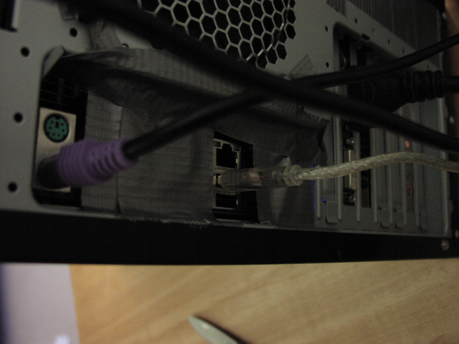

i was lazy when i put together the system last, and left out the rear I/O panel, not thinking about the fact that air would travel through the void space, making a cooling loop.
SOOOOOO... i decided to duct tape over the unused portions of that IO panel, to limit the amount of airflow that can go through. i dont know if it'll have any effect... probably not. but it makes me feel better.

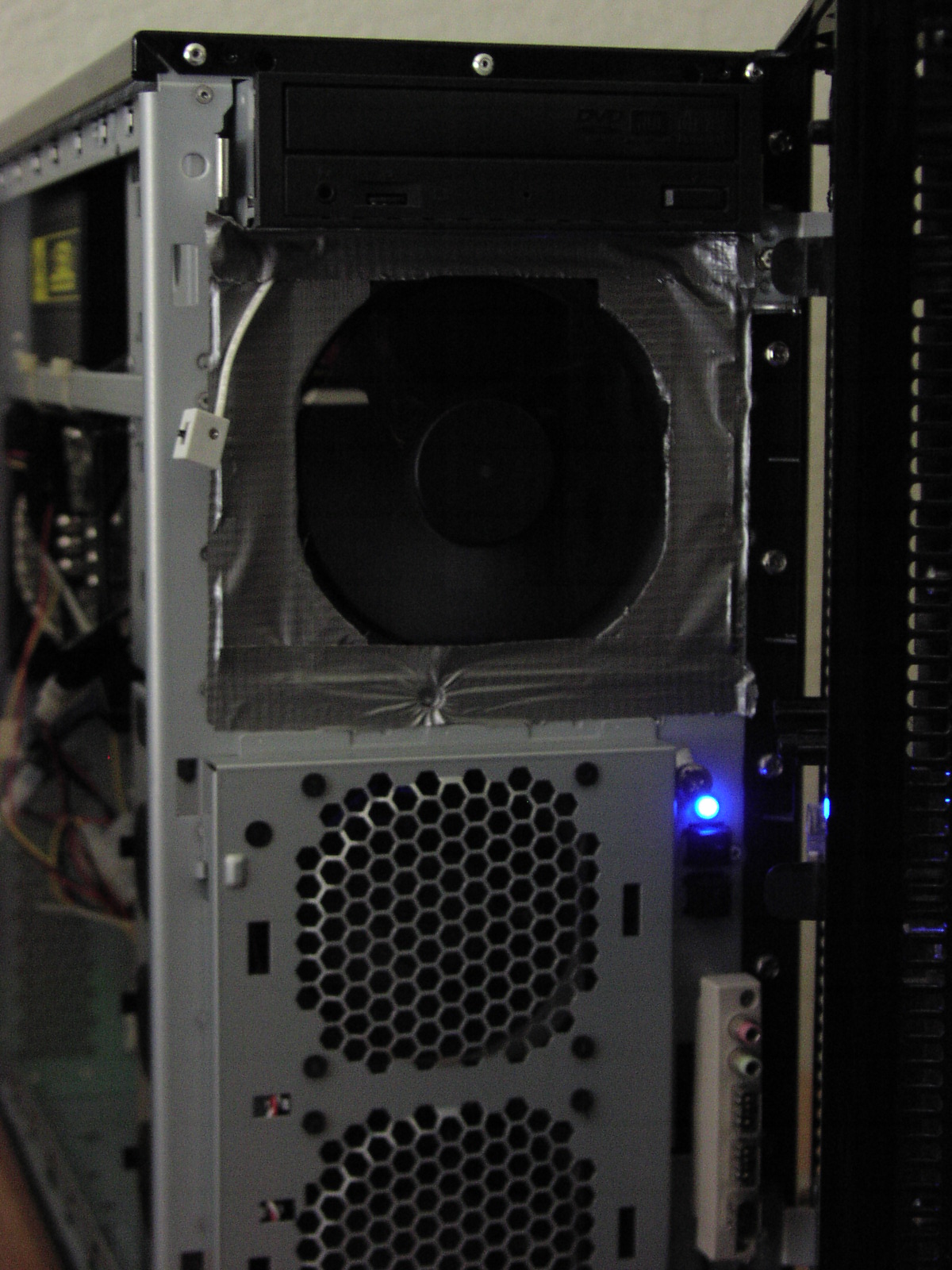

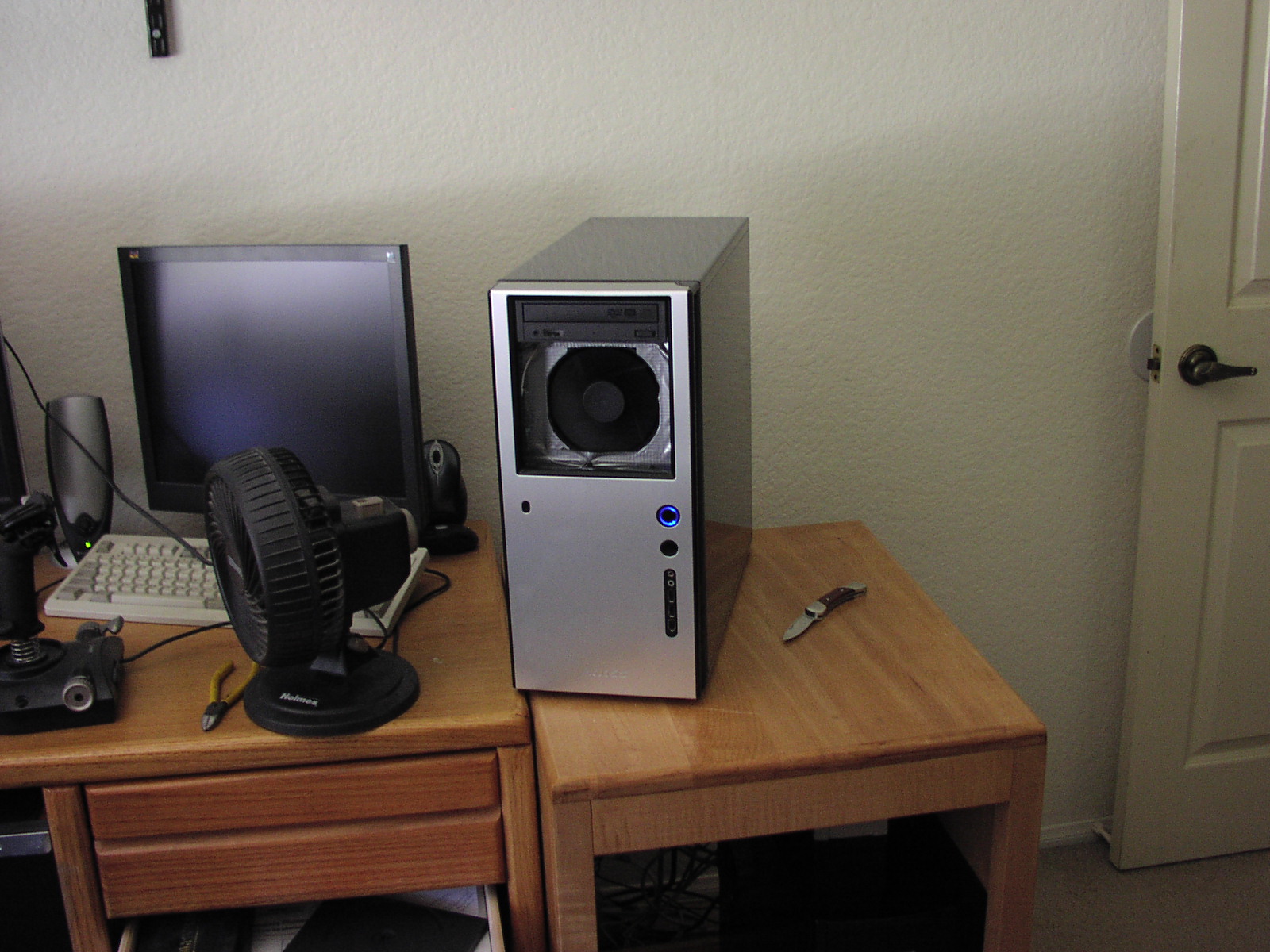

here's some pics of it if anyone's interested :p
http://www.manwhoring.com/lineage/fayd/pics/fanmod1.jpg
http://www.manwhoring.com/lineage/fayd/pics/fanmod2.jpg
http://www.manwhoring.com/lineage/fayd/pics/fanmod3.jpg
http://www.manwhoring.com/lineage/fayd/pics/fanmod4.jpg
they're all 1600x1200, so consider yourself warned.
it's only temporary... i'm gonna rig up something more permanent at the same time i figure out how to more effectively exhaust the video card, as well as buying some higher quality fans for the 92mm fan bays.
