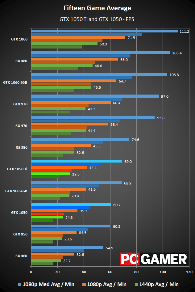

I would imagine such a card would be faster than GTX 1050 TI based on the following review showing R9 380 (1792sp @ 970 Mhz) beating GTX 1050 Ti:
http://www.pcgamer.com/gtx-1050-ti-review/
So perhaps the consumer version could have relaxed binning?
