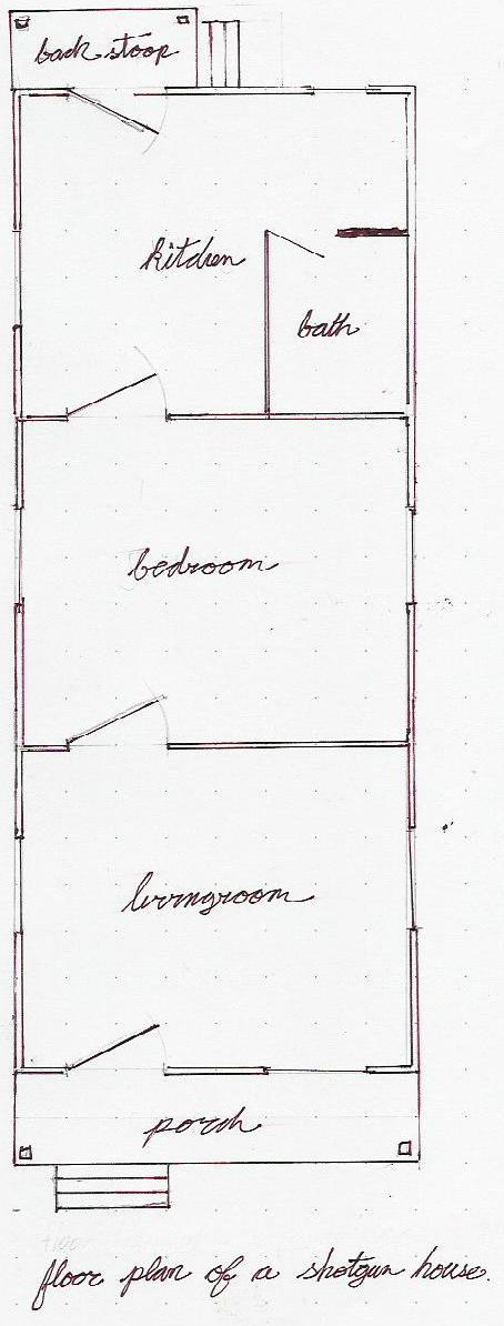

I was listening to the radio, and they made mention of the shotgun house. I've know basically what they were for a long time, but didn't know the details, so I looked it up. The floor plan's kind of bizarre. You have to walk through the bedroom to get to the kitchen. Any of you ever live in something like that?
Growing up, the bedroom was always considered a private subdivision of the house. To go inside, you had to specifically be invited. Making it part of the 'hallway' turns that concept on its ass.

I can only think they were made because they were super cheap and easy to build, and required minimal frontal space. Fewer walls to build and all the space is used, with none 'wasted' on a hallway. I don't think most people would choose that if they had options.
But you have more siding per square foot by building a house so long instead of more square. So I'm doubting it's efficiency.
It's for efficiency in cooling. They said the open floor plan allows breeze through the whole house. They also had relatively high ceilings so the heat would stay above occupation level.
There was also tax and property considerations that made economic sense at the time.
That makes sense. They're not uncommon here. Poorer neighborhoods. Have always been told that it was called shotgun because you could open the doors and fire a shotgun in the front and out the back without hitting anything.

The kitchen in back was essential to development of the blues as the configuration facilitated access for the backdoor man. It was also to allow for better cooling while cooking with the cross breeze plus back door open.

How is that possible?
Assuming a rectangular plan -
For a given square footage, the minimum perimeter (total siding length) will have all sides equal.
Or, for a given amount of siding, the maximum internal square footage is 4 equal sides.
So for a 100 sq feet 10x10 gives a total perimeter of 40 feet, 12.5x8 is 41 etc.
I see the math but can't get my brain around it. Must be a fart.:\
Likewise, if heating or cooling with air conditioning, the increased surface area from a non-square floor plan causes an increase in heating (or cooling) losses.
