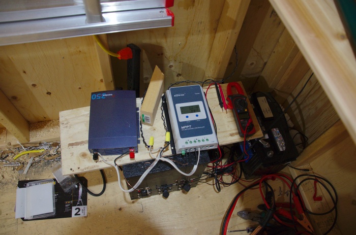

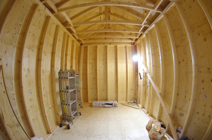

Started this last year, figured I'd share. It's mostly done at this point, just need to finish shelving inside, and do a more permanent power solution. Right now I have a 60w solar panel on the ground connected to a MPPT controller and a 80ah battery. It's all just sitting on the ground and not really in a proper enclosure.

Probably won't insulate the rest, but figured I'd do the parts that I can't get to after. Originally I was thinking of insulating the whole thing and trying to heat it via solar heat or some other renewable source, mostly just to see if it can be done, but I also so the battery and solar and any other electronics don't freeze, but think I'll just build a separate insulated box for that. I'm still trying to source out some large solar panels but it's proving to be tough. They only really seem to sell them down south and the shipping cost is absurd.
Today I finished the shelving. Now if I did want to insulate it would be harder as I would not be able to install the vapour barrier continuously and end up with lot of seams, but I'll cross that bridge when/if I get there. I still have some more electrical I want to do like outside lights etc so by not insulating I don't have to feel rushed doing those things. It's not really a hurry.

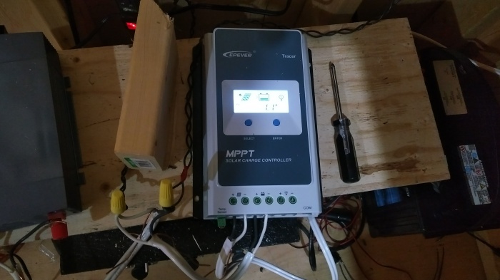

Oh and the really crude temporary solar setup:
Eventually that will be in a proper panel, and I'll have some automation to monitor voltage, shut power if it's low, etc. That black box used to do just that, but I moved to a bigger charge controller and battery so not using that box anymore.

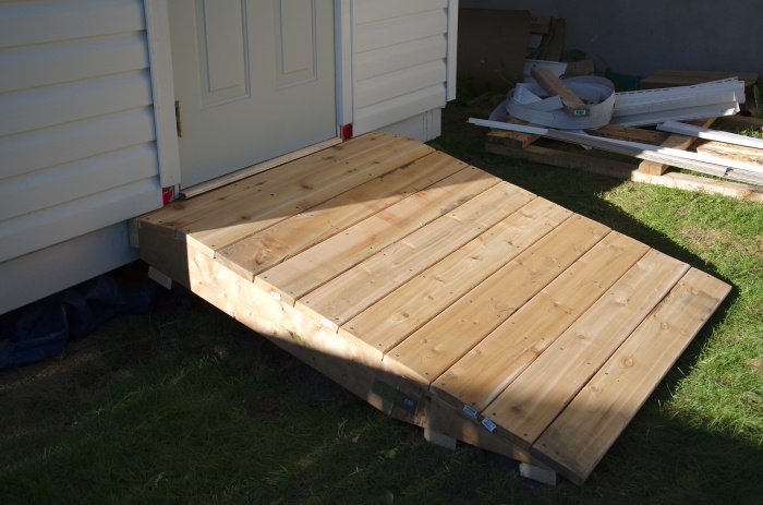

the trim on the outside of the door, around the edge. it should extend down to the bottom of the sill
Oh never heard it called that before. Yeah I messed up the measurement when I cut it. I then left it in case I was going to put an edge on the ramp, but didn't. I put a small piece there now. Didn't really want to buy two more pieces so I kinda did a crap fix instead. :p
