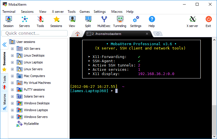

Don't really know what access rights you have on Linux server. Only FTP and SSH?
I''m not Linux expert either.
Saw this
Oops, already mentioned by purbeast0
Also
