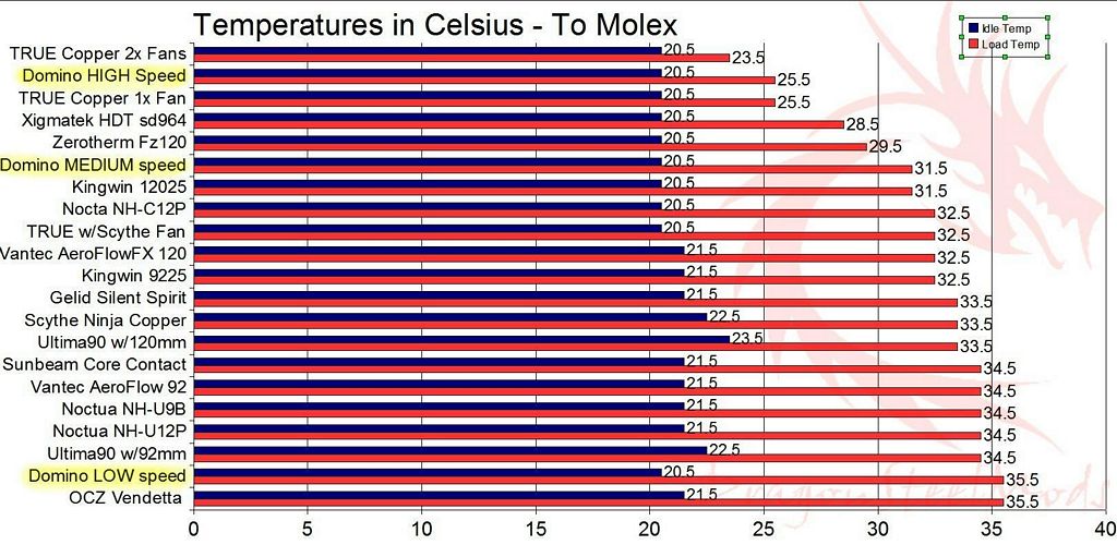

Thanks for the responses guys. I was able to find tons of reviews for this thing and most compared it to high end air coolers just like you said. TRUE actually does beat the Domino cooler but only with a 2 fan setup. Benchmarks
Great...more benchmarks. I have one and have used it as I was testing my quad. It will handle stock loads, but don't throw any OC's at it...it just doesn't have the thermal capacity (in real life) to be a decent solution...and it will get loud.
A high-end air cooler will be quieter then the Domino when it is in performance mode...trust me...and like I said, if you want to go that way I really do have a brand new Domino with upgraded firmware straight from CoolIT that I will let go cheap.
