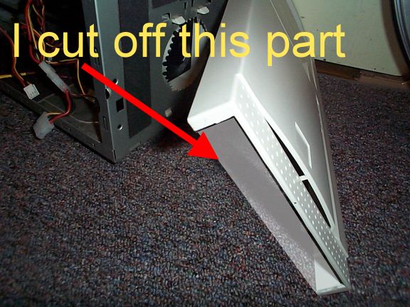

If you have two intake fans in the front of the Q500, you might want to do a mod to the bezel to increase its airflow capacity. I cut the bottom off of my bezel: Pic at Tripod, you may need to click the &quot;follow-through&quot; link to reach it.
