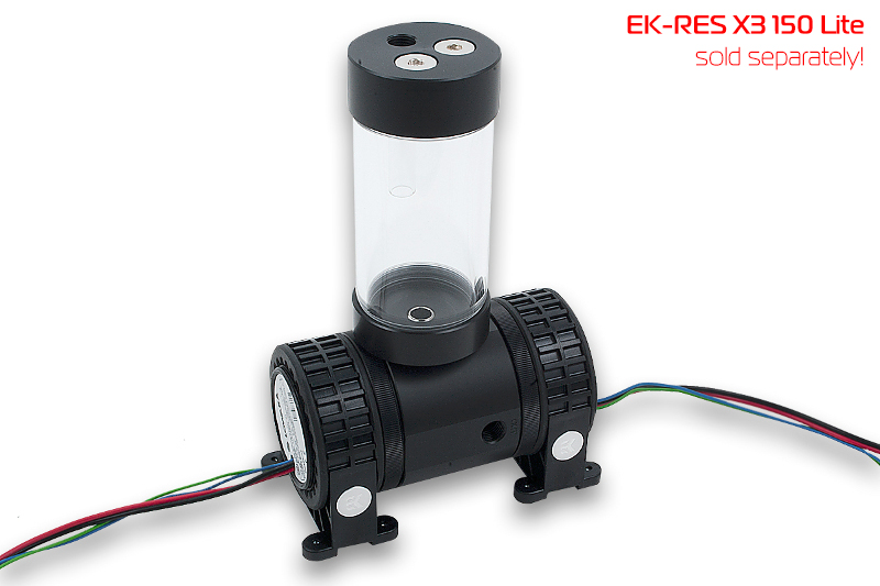

With three pumps, you won't need three separate reservoirs unless you really like the symmetrical look. As far as restriction goes and concern about the pump failing, I currently have the two 420 GTS rads, the 480 is a EK PE, and the 360 is an EK XE.
It was definitely for symmetry and aesthetics. 😉
