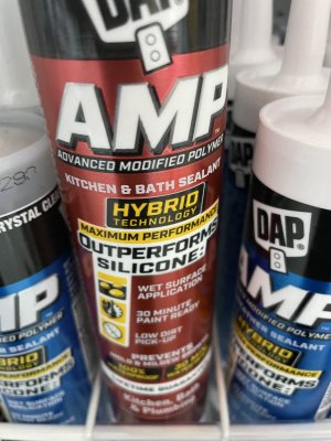

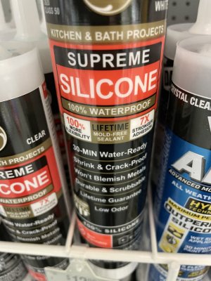

I need to re caulk my bathtub. Should I use a pure silicone or one of the new modified silicone?
I have a moderate sized gap between the 1960 tub and a surround someone added at some point.
Choice #1
Choice #2

I don't like silicone at the tub /tile seam. It almost always gets mold behind it and it's a nightmare to remove the stuff. I always used dap tub and tile caulking. Holds up reasonably well, and is removeable.
It's been my opinion for years that silicone shouldn't be sold to the general public as the majority of time's it's incorrectly used and creates more problems than it solves. It's a great product used correctly, and a nightmare when poorly installed or in the wrong location.

wait! the gap between the tub and upper surround should not be caulked generally.
if it's tile, the tile is not a waterproof barrier, the waterproof membraine should be behind the tile and this gap allows water that gets behind it to drain out and air to get in. I have recaulked and repaired grout and tile showers that when caulked improperly and the then removed, gallons of stinky water drain out from behind the tile.
when fiberglass or similar this joint is normally "shingled" or lapped so that water would have to travel several inches up to get past this joint. when its left open it provides a gap that can dry out instead of leaky caulk that traps water behind it and molds.
give us some pictures and more details. your situation could be different but its likely this should not be caulked in the first place.
and @Greenman is correct about silicone. very few correct uses for this product. I'm a fan of OSI quad and their other products. SashCo also makes some great sealants. just remember, caulk is not a waterproofing strategy, it's a band-aid.
