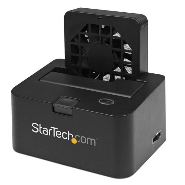

or this one.
http://www.newegg.com/Product/Produc...82E16817707260
http://www.amazon.com/StarTech-Super.../dp/B0055PL2YI

or this one.
