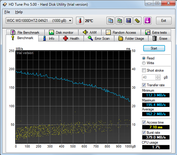

From what I can garner, a mechanical hard drive has yet to sustainably saturate the SATA 1 (1.5GB) interface.
I suppose it depends on your definition of "sustainably".
Newer 1TB/platter 7200RPM drives can easily exceed 150MB/sec (the SATA1 limit) for a significant portion of their area. Here's my 1TB VelociRaptor, a 10,000RPM drive which is the fastest SATA drive you can get:
As you can see, it exceeds 150MB/sec for about 70% of its surface area.
