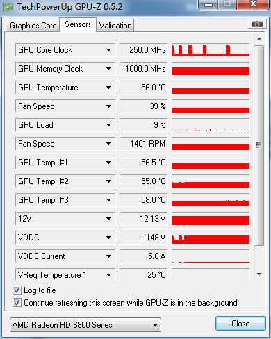

my sapphire hd 6850 idle temperature is a bit high
I was holding the plastic fan cover few times and during the installation, would that be the problem that i have lap the heatsink?

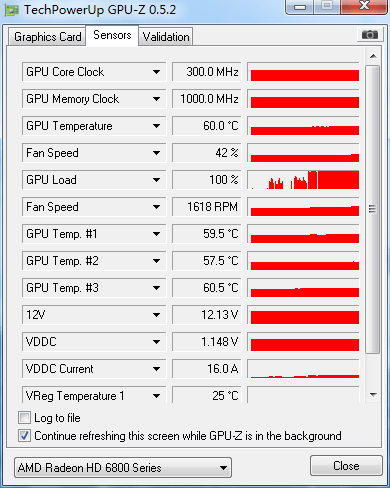

also this worried me too, is it normal? almost full load of GPU and GPU Core clock is sitting at 300MHZ

h3blade, what have you done to move GPU clock from 250 to 300?
Your first image shows idling with 2 monitors (all correct). Second image shows change from idle to load with GPU clock stuck at 300. Have you used overdrive or a tweak to change settings?

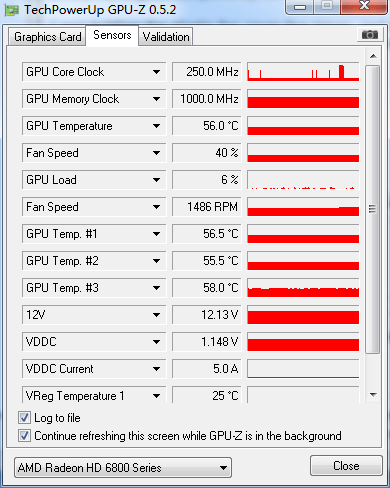

I have uninstalled easytune6 and the GPU core clock is able to move between 250-775 now depends on GPU Load, however the memory cloak remain the same, constantly at 1000Mhz, according to member happy medium that has to do with dual monitors setup, which I have also heard on GTX570 as well, the memory cloak would not decrease itself during idle.
ImDonly1 is correct, I should have GPU at 100 and memory cloak at 150 at idle.
To summary, my new problem is that this hd 6850 is idle at Core 250 and memory 1000.
I will try to unplug my second monitor and report back

Idle is 250/1000 with 2 monitors connected. To disconnect you have to physically unplug usually, disabling in Windows and turning the monitor off doesn't count and it will stay in the two monitor state. You have to remove the plug from the card.

after removing second monitor cable attached to the video card, the GPU-Z has reported that GPU is idle at 100 and Memory cloak 300.
So dual monitor is the reason that causing memory cloak maxed at 1000Mhz.
