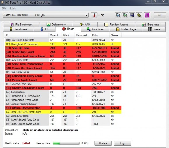

How to see if you have degraded SATA ports:
http://translate.google.com/transla...ab501.ro/stiri/p67-s-ata-bug-cum-se-manifesta
5% error rate in 3 weeks, not 3 years??
Hard drive failure, not SATA failure.
