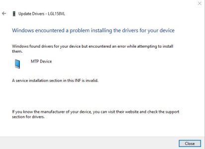

I used to see this phone fine and copy files to it using this laptop...
I opt to update driver, automatic search method, it looks and this comes up:LG phone driver installation error.jpg

So, I swap one LG phone for the other I've been using, same model, OS. Get same message but a few seconds later at bottom right of Windows 10 screen says "Setting up..." and a few seconds later "Device is setup and ready to go." However, I do not see it in File Explorer.

Also, if I check properties in Device Manager, it says no driver installed.
