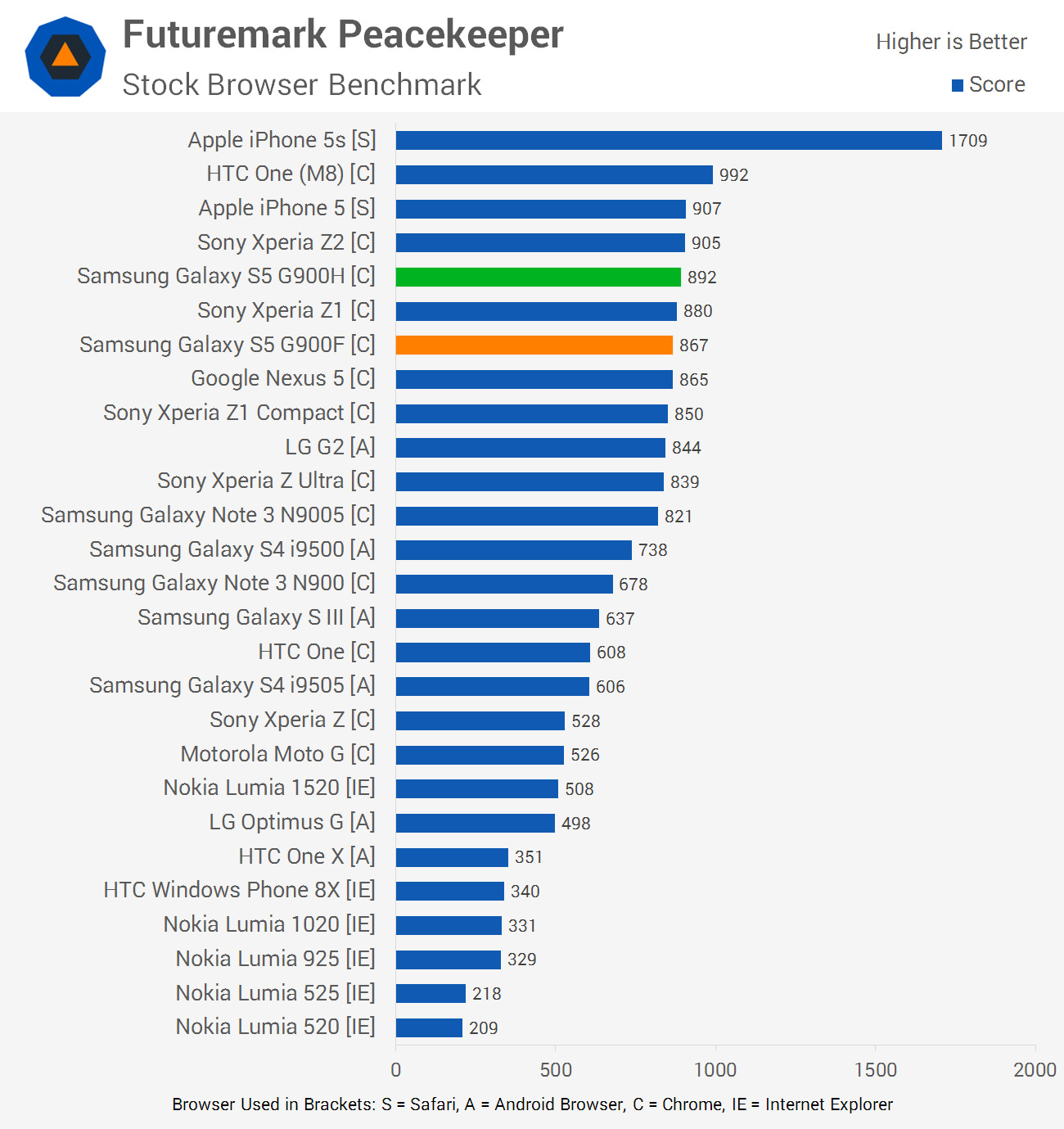

Thala
Nov 12, 2014
1,355
653
I get why they use Chrome to compare across Android devices, but it does seem a bit unfair to compare against an optimized iOS-Safari score and not at least include Android-default browser in the actual device review. It doesn't need to be included in the long term comparison tables, but at least include it in the primary review.
That's the reason JavaScript/html benchmarks should not be used at all for SoC comparision as they are mostly a measure of the JavaScript engine implementation. This holds even more when you compare different ISAs like ARM vs x86.
It only has some value when you fix the browser and fix the ISA and only cross compare within this group.
I don't get why AnandTech so heavily relies on JavaScript when comparing SoCs.
