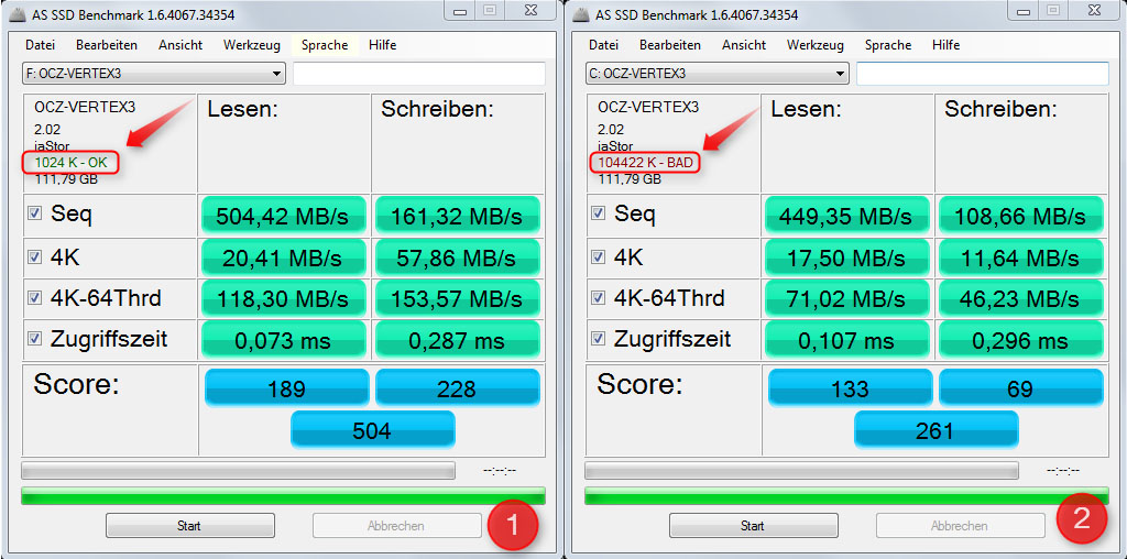

Depending on how you installed the OS or made the partition on the SSD, it could have an unaligned partition, so that every access to the SSD takes much longer than normally.
So, for example, you cloned over your HD to the SSD, and the cloning program didn't create the SSD partition on a 1K boundary.
You use AS SSD, and pick the SSD, and it should say in green text if it is OK or not.
Like so: http://www.overclock.net/t/1226963/how-to-properly-re-align-your-ssd-hdd-partitions
298
Mine says "OK"
298
And if you formatted with Windows 8+ it's guaranteed to be aligned correctly. Just in case anyone was wondering.
Either Acronis Disk Director 11 Update 2, or True Image 2014 or later (maybe earlier) will automatically align an SSD properly if the OS was transferred via clone, or the disk was prepared with Acronis before installing Windows 7. I think proof of the pudding was to run -- what was it? -- MSINFO32 followed by Components->Storage->Disks. Look for Partition Starting Offset. It must be perfectly divisible by 4,096 to produce an integer value.
