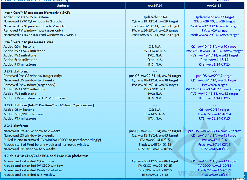

The RTS (Release Time Schedule?) only gets shifted out more and more.
In one quarter (=13 weeks) the worst case RTS for quad cores was
delayed by 21 weeks from week 15/2015 (April 2015) to week 36/2015
(September 2015)
Worst case RTS for the first 14nm products is now week 3/2015.
