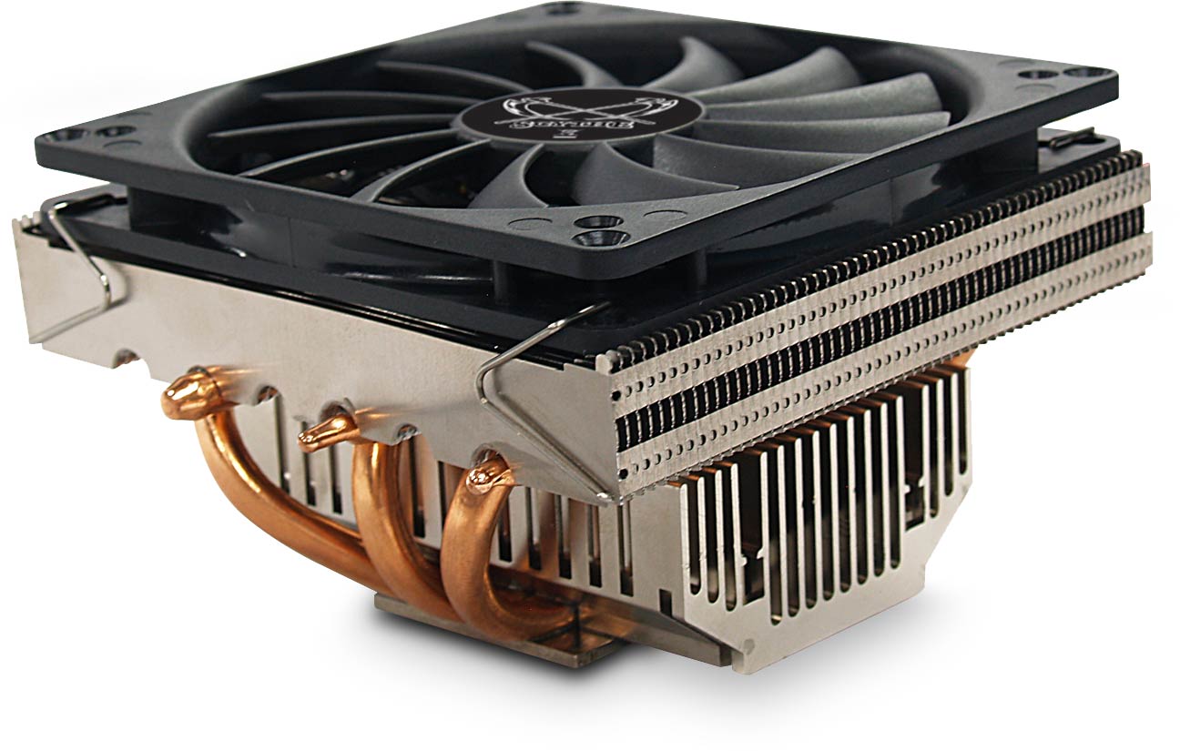

I already own the shiruken REV B (I always get it confused with the big shiruken which has 5 heat pipes) for my current system and i am very pleased with it. Because of the large fan and the way the heatsink is designed, it is also very good at cooling the surrounding electronics and is AM4 compatible because it uses the plastic retainer clips.
The other real reason is that i was planning for a 1600x which does not have a cooler supplied.
This cooler is rated for up to 95W and it seems that even a 1600x at all cores full load does not consume more than 75 watts.
Anyway, a surplus of cooling capabilities is always good.

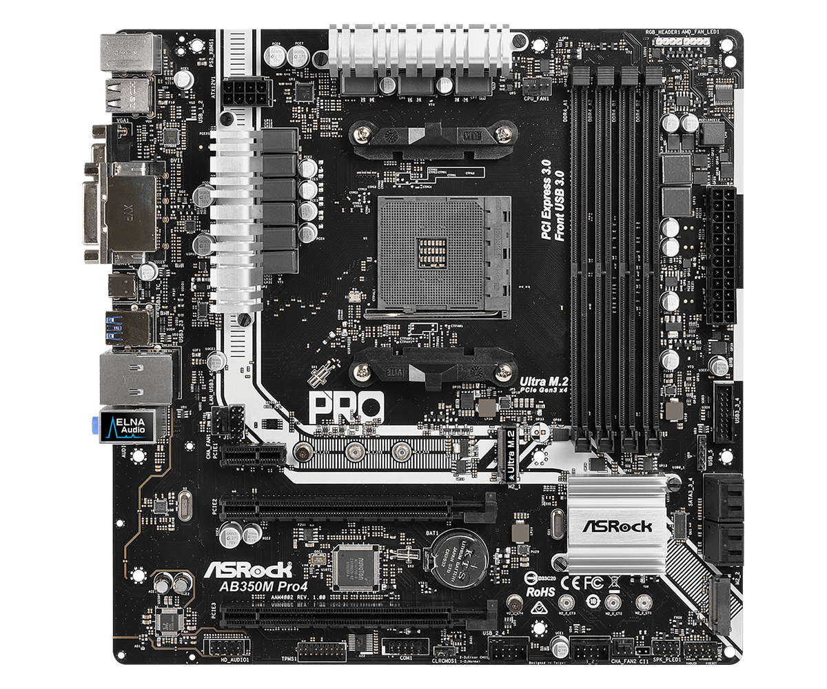

Why the AB350M, rather than the AB350M Pro4? I think that the Pro4 has an additional SATA M.2 slot, and better VRMs. (Still only a three-phase for CPU vcore, but doubled.) For like $5-10 USD more money.
I own several of the Pro4 boards, and the VRMs are pretty robust, that I can see. Except, there's only limited settings for OC. No LLC or vSoC settings. But it will let you either specify a manual clock, and manual voltage. RAM compatibility could be better. (I've got a couple of rigs with Team Vulcan DDR4-3000 2x8GB 16-18-18-38 1.350V, they won't run 100% reliably at higher than 2667. Will boot, sometimes, at 2800.)
Well, the extra M2 slot and second pcie slot for a second gpu i do not need.
And i was hoping that the more easy layout would improve routing and thus memory capability.
Are you sure that the AB350M only has 3 phases without doublers ? I see 6 storage inductors on the left for both boards that i assumed were for the cpu cores . I thought the 3 storage inductors on the top were only for memory and I/O.

Look for buildzoid's video on the AB350M (Pro4) VRMs on YouTube. He goes over all of that. Apparently, the VRM controller that they use, only has three channels for the CPU VRMs, but they drive a pair of MOSFETs and inductors each, so it's got the power of 6 phases, but it really only has three, so overclocking and voltage stability may suffer slightly.
I haven't had too much trouble with it, but my overclocking requires a lot of voltage to get stable, compared to some people that have motherboards with all "real" vcore phases, and LLC settings available in the UEFI.
Edit: Saw that Newegg on ebay wanted only $59.99 FS for the AB350M, and from your pics, it seems like it has similar VRMs to the Pro4, so I snagged a couple, for future Ryzen 3 builds. (Trying to decide between 1200 and 1300X. Want 3.8+Ghz on them. Heard that the 1300X is binned better.)
