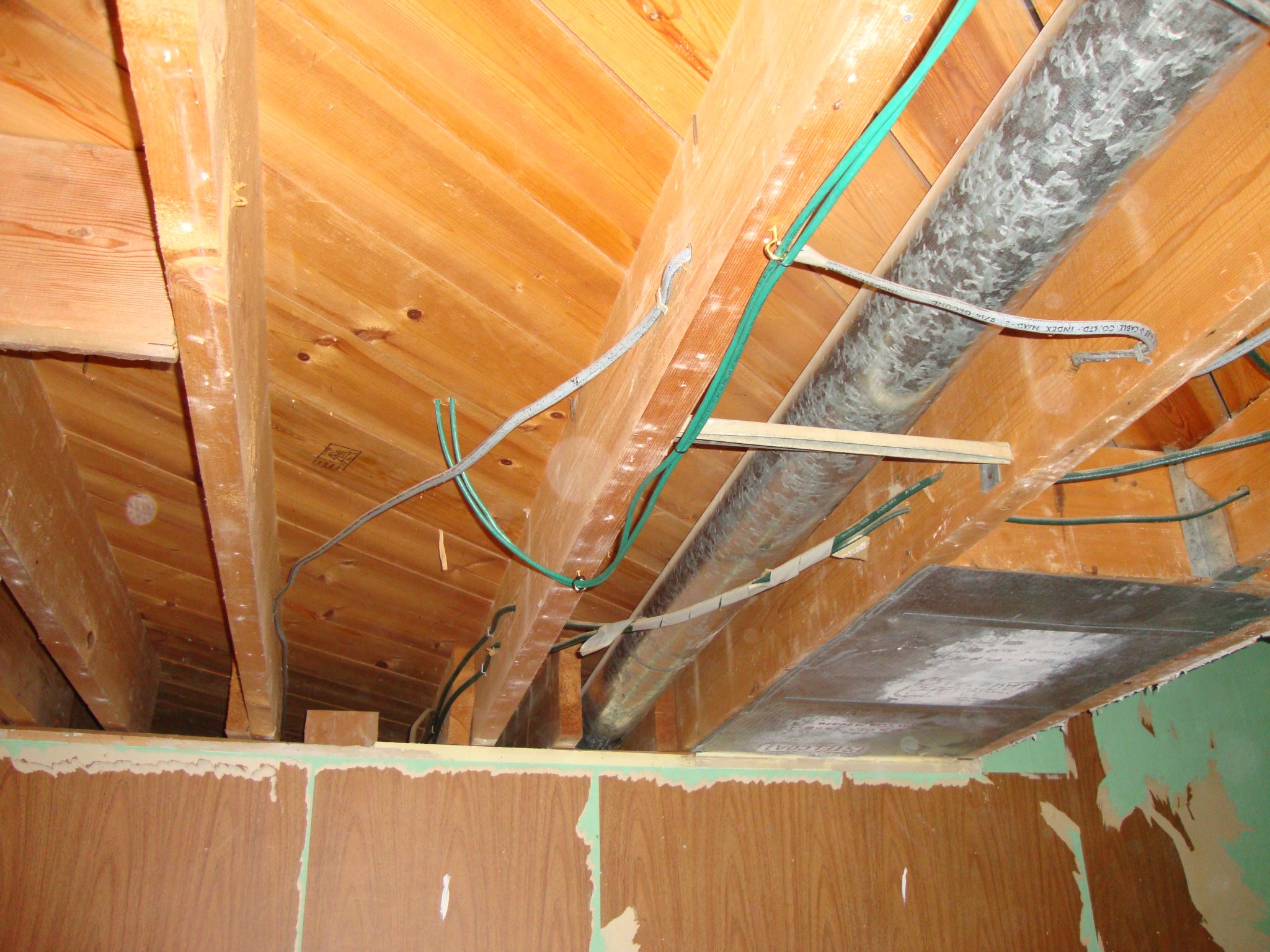

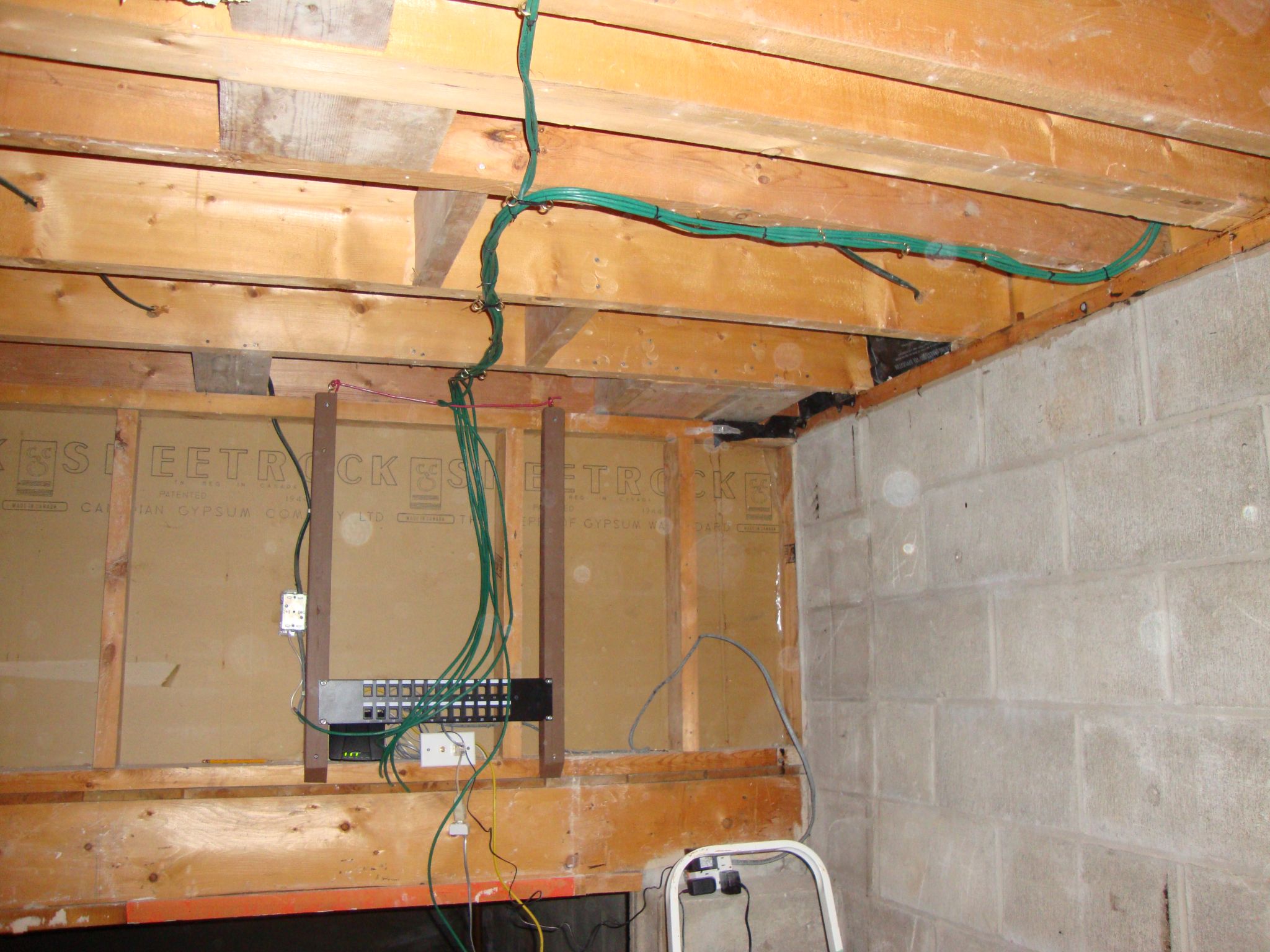

Not the BEST setup, but here's how I did mine:
http://gal.redsquirrel.me/images/house_projects/basement_and_data_infrastructure/dsc02632.JPG
http://gal.redsquirrel.me/images/house_projects/basement_and_data_infrastructure/dsc02631.JPG
That electrical was already there mind you, I would normally bring it up higher. The duct was also in the way, so probably why it's lower.
