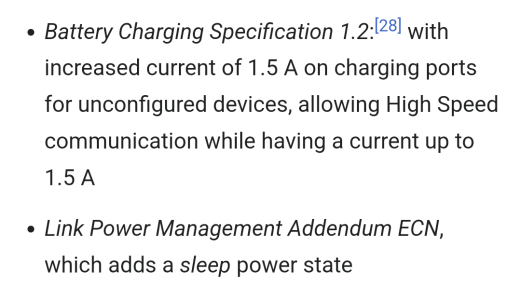

No idea where you got that, it clearly states this under the power section:
"USB up to 2.0 allows a host or hub to provide up to 2.5 W to each device, in five discrete steps of 100 mA"
Under the history section for USB 2.0.
Hail The Brain Slug
Oct 10, 2005
3,828
3,206
I don't know if that applies here. The port and device both have to support battery charging 1.2.
"The portable device and USB host or hub both need to support BC1.2, which detects the USB D+ and D- contacts. Once this is complete and support for BC1.2 is confirmed, Vbus provides 1500mA current for recharging"
I seem to recall ports supporting this being pretty rare, a system might have one and it was specially labeled. Any random USB 2.0 port very likely doesn't support it.
