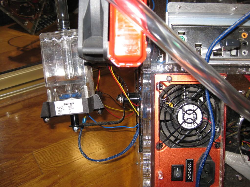

You could always mount the pump on your rear 120 exhaust like this:
http://i125.photobucket.com/al...aigomorla/IMG_0073.jpg
http://i125.photobucket.com/al...aigomorla/IMG_0074.jpg
Thats called a UN Design bracket by Dave, a great guy, and i recomend it if you dont want to go ghetto on pump mounting.
