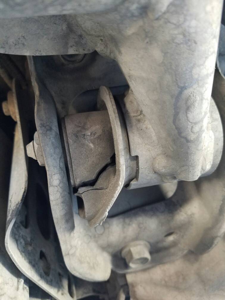

You may want to check your control arms.
From a 2004 Civic.
Passenger side control arm new vs stock
Driver side control arm new vs stock
2004 PT control arm, bushing totally separated from the control arm
2000 Honda insight trailer bushing
1994 Volvo strut mount
Rubber parts fail with oxidation and sun exposure, it's just part of the owner ship.
From a 2004 Civic.
Rubber parts fails, it's just part of the owner ship.

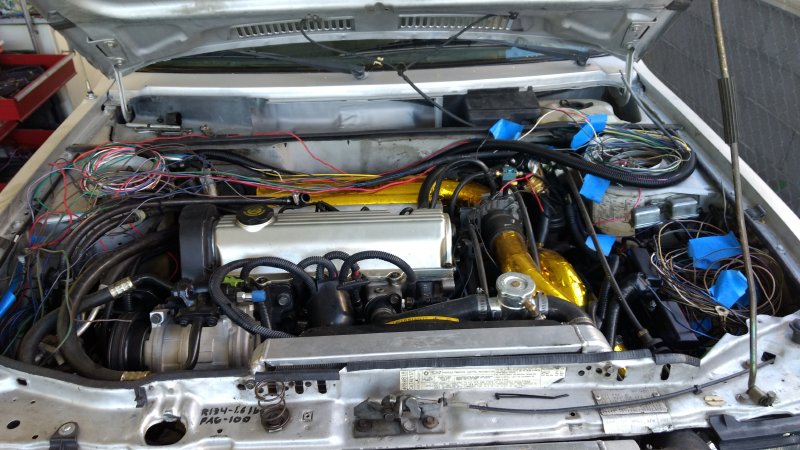

I actually ran MegaSquirt for a while and have ECU Masters EMU now -- the problem was the wiring to the OEM igniter, which was still used by both ECUs. I changed to coil on plug and all of my problems vanished (and then I found a damaged wire in the OEM igniter harness).
